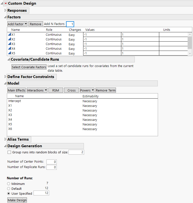

1. Select DOE > Custom Design.
2. In the Factors section, type 6 next to Add N Factors.
3. Click Add Factor > Continuous.
4. Click Continue.
The Model section appears. It includes only main effects with Estimability designated as Necessary. This means that all main effects are estimable in the design that is generated.
Figure 5.2 Custom Design Window Showing the Model Section
Keep the default of 12 runs.

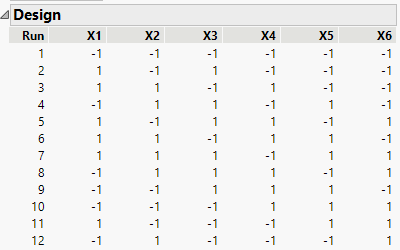

7. Click Make Design.
Figure 5.3 Design for Main Effects Only

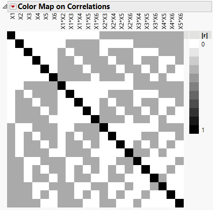

8. Open the Design Evaluation > Color Map on Correlations section.
Figure 5.4 Color Map on Correlations
Notice the following:
The main effects are represented by the six terms in the upper left corner of the map.
The white coloring corresponding to the correlations of the six main effects with other main effects indicates correlations of 0. This means that all main effects are orthogonal and can be estimated independently of each other.
The light gray color in the squares corresponding to some two-way interactions indicates that the corresponding effects are correlated. This means that these effects cannot be estimated independently of other effects. Hover over these squares to see the exact correlation.
Notice that no effects are completely confounded with each other. The black squares, indicating absolute correlations of 1, are only on the main diagonal.

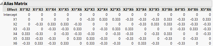

9. Open the Design Evaluation > Alias Matrix section.
Figure 5.5 Alias Matrix
Alias Matrix
The Alias Matrix shows how the coefficients of the main effect terms in the model are biased by potentially active two-factor interaction effects. The column labels identify interactions. For example, in the X1 row, the column X2*X3 has a value of -0.33 and the column X2*X4 has a value of 0.333. This means that the expected value of the main effect of X1 is the sum of the main effect of X1 plus -0.33 times the effect of X2*X3, plus 0.333 times the effect of X2*X4, and so on, for the rest of the X1 row. In order for the estimate of the main effect of X1 to be meaningful, you must assume that these interactions are negligible in size compared to the effect of X1.
Tip: The Alias Matrix is a generalization of the confounding pattern in fractional factorial designs.
