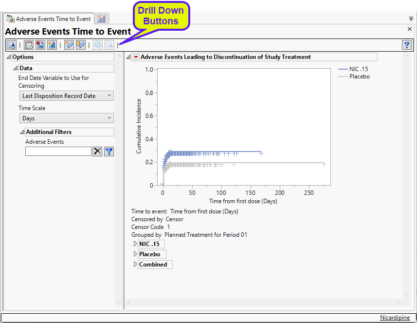

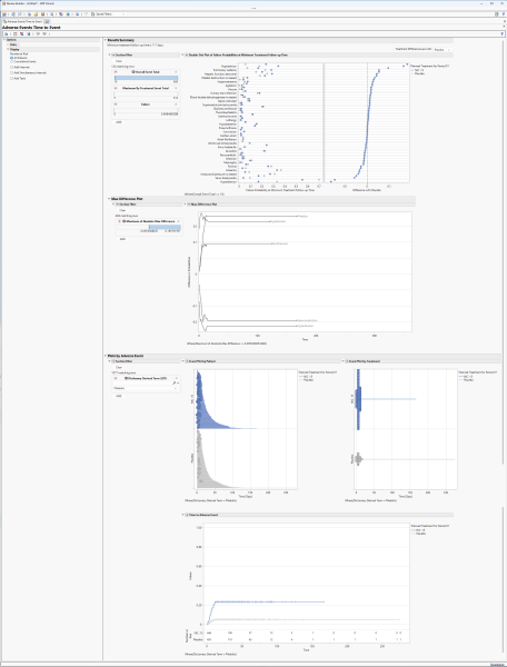

Report Results Description
Running this report with the Nicardipine sample data, where the Treatment emergent events option was selected for event type and defaults were selected for all other options, generates the tabbed Results shown below (click image to enlarge). Output from the report is organized into sections. Each section contains one or more plots, data panels, data filters, or other elements that facilitate your analysis.
The Adverse Events Time to Event report generates analyses for studies with one or more treatment arms and computes treatment differences between all treatments for studies with two or more treatment arms.
The Report contains the following elements:
Results Summary

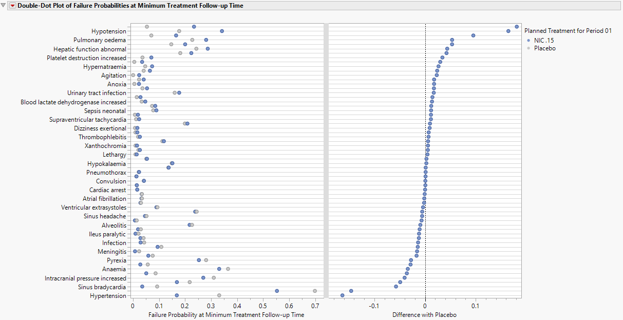

Double-Dot Plot
For studies with two or more treatment arms, differences between the treatment arms are compared at the minimum of the maximum follow-up times for the treatments. Here, the minimum follow-up time is 125 days.
This plot above (click image to enlarge) is a modification to the more common dot-forest plot that is provided in other reports, as confidence intervals between the difference in probabilities estimated from two Kaplan-Meier curves are generally not available. The left panel presents the probability of a patient experiencing an event at the end of the study (here, 125 days). The right panel presents the difference in probabilities between the two treatments (here, Nicardipine minus Placebo, though this can be modified using the Treatment Differences are With selector). The y-axis is sorted so that events with greatest risk for Nicardipine are at the top of the figure while those with greatest risk on placebo are on the bottom. This highlights events that may be of interest to examine further. Note that for a single arm study, a dot-forest is provided with 95% confidence intervals provided around the individual estimate of event probability.
The limitation of the dot-forest plot, however, is that it only communicates the risk between treatments at a single point in time. For two or more treatments, an alternative to screen events across the entirety of follow-up, the max difference plot, shown below, can be utilized.
Data Filter
The data filter has variables to subset the dot-forest plot by the overall event total, the maximum by treatment event total, or the Failure, though other variables may be added.

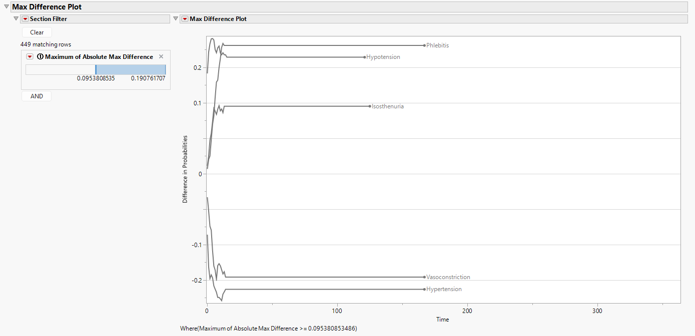

Max Difference Plot
This plot above (click image to enlarge) computes the difference in Kaplan-Meier curves across the duration of follow up. When more than 2 treatments are available, the difference between the maximum probability and the minimum probability are summarized. For two treatments, the direction of the treatment differences are considered to show which of the two treatments has greater risk. For example, the above figure shows greater risk for Nicardipine for phlebitis, hypotension, and isosthenuria, while placebo shows elevated risk for vasoconstriction and hypertension. Note that this plot is filtered to those events that have been limited to those with at least a difference of 9.17% observed at least once along follow up.

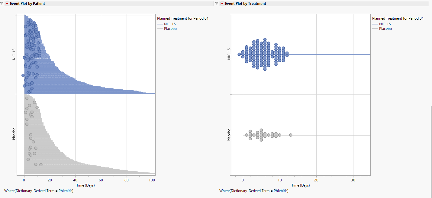

Plots by Adverse Event
The remaining plots are specific to an individual AE which can be selected by the Data Filter. By default, the event at the top of the double-dot plot is selected (here, phlebitis). Event plots are presented below (click image to enlarge).
Event Plots
The plot on the left is a patient-level event plot which summarizes the follow-up for each patient with the first event highlighted on the plot. If multiple events were experienced on that same date, this would be denoted by differing bubble size. Though difficult to see for all patients, once a patient experiences an event, the bar becomes dashed making it easier to distinguish follow up events that occur after the first event. This helps the user determine whether particular events lead to patient discontinuation after the first event. The right plot is a treatment-level event plot where all events are presented along a line which represents the maximum follow up experienced on the treatment arm. As visible from either plot, patients experience their first phlebitis event within 15 days, and the nicardipine arm had far more patients experience events.

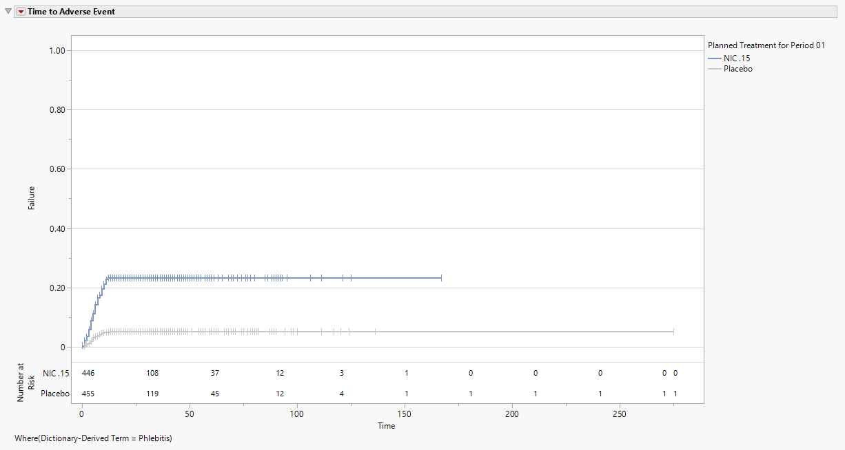

Time to Adverse Event

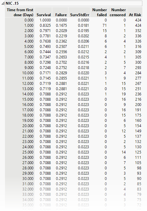

This plot (click image to enlarge) is a failure-type Kaplan-Meier plot, which starts at 0 (no one has the event) with increasing probability to communicate the cumulative proportion of patients who have experienced a phlebitis event. Based on the tests and narrow confidence intervals, one can conclude there is a difference in phlebitis events between the two treatments.
The Number at Risk table, displayed at the bottom of the figure when All Patients is selected using the Number at Risk display option, communicates the number of patients who have yet to have an event or be censored. When Cumulative Events is selected using the Number at Risk display option, the total number of patients with events up to and including a particular time are presented in the risk table, which has now been renamed Cumulative Events. Numbers are presented every 30 days and at the last day of follow up.
