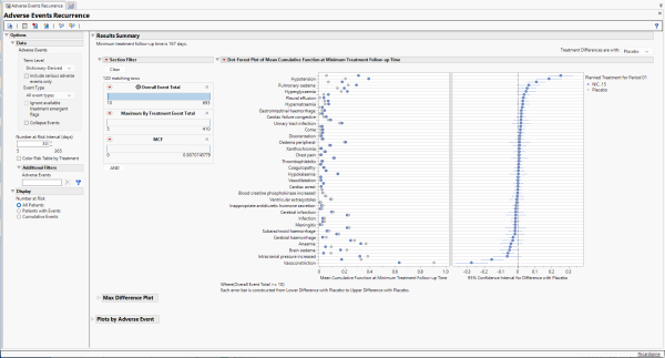

Running this report with the Nicardipine sample data, where the On treatment events option was selected for event type and defaults were selected for all other options, generates the tabbed Results shown below (click image to enlarge). Output from the report is organized into sections. Each section contains one or more plots, data panels, data filters, or other elements that facilitate your analysis.
The Recurrence Report generates analyses for studies with one or more treatment arms and computes treatment differences between all treatments for studies with two or more treatment arms.
The Report contains the following elements:
Results Summary
For studies with two or more treatment arms, differences between the treatment arms are compared at the minimum of the maximum follow-up times for the treatments. Here, the minimum follow-up time is 17.5 days.

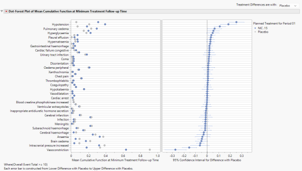

Dot-Forest Plot Summary of all AEs
For studies with two or more treatment arms, differences between the treatment arms are compared at the minimum of the maximum follow-up times for the treatments. Here, the minimum follow-up time is 17.4 days. The dot plot in the left panel shows the value of the MCF at 17.4 days while the forest plot displays the 95% confidence interval for the difference in NIC. 15 – Placebo MCFs. This difference can be reversed by altering the control arm with the combo box. From the dot plot, the MCF 0.3844 and 0.0756 for NIC. 15 and Placebo, respectively, for phlebitis. In other words, patients can expect to experience 0.3844 or 0.0756 phlebitis events by 17.4 days for NIC. 15 and Placebo, respectively. So, one in every 1/0.3844 = 2.6 patients will experience a phlebitis event by 17.4 days.
Note: For single arm studies, the dot-forest plot will be replaced with a forest plot that presents the 95% confidence intervals for the MCF computed at the maximum follow-up time within the treatment arm.

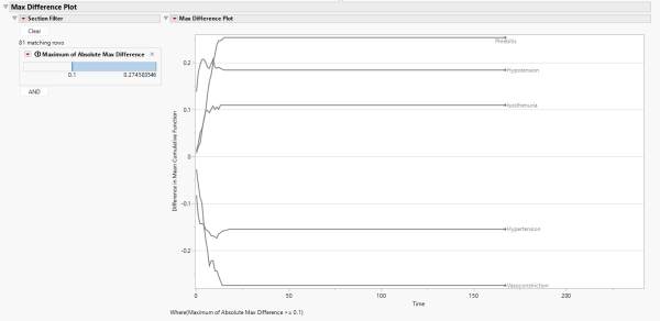

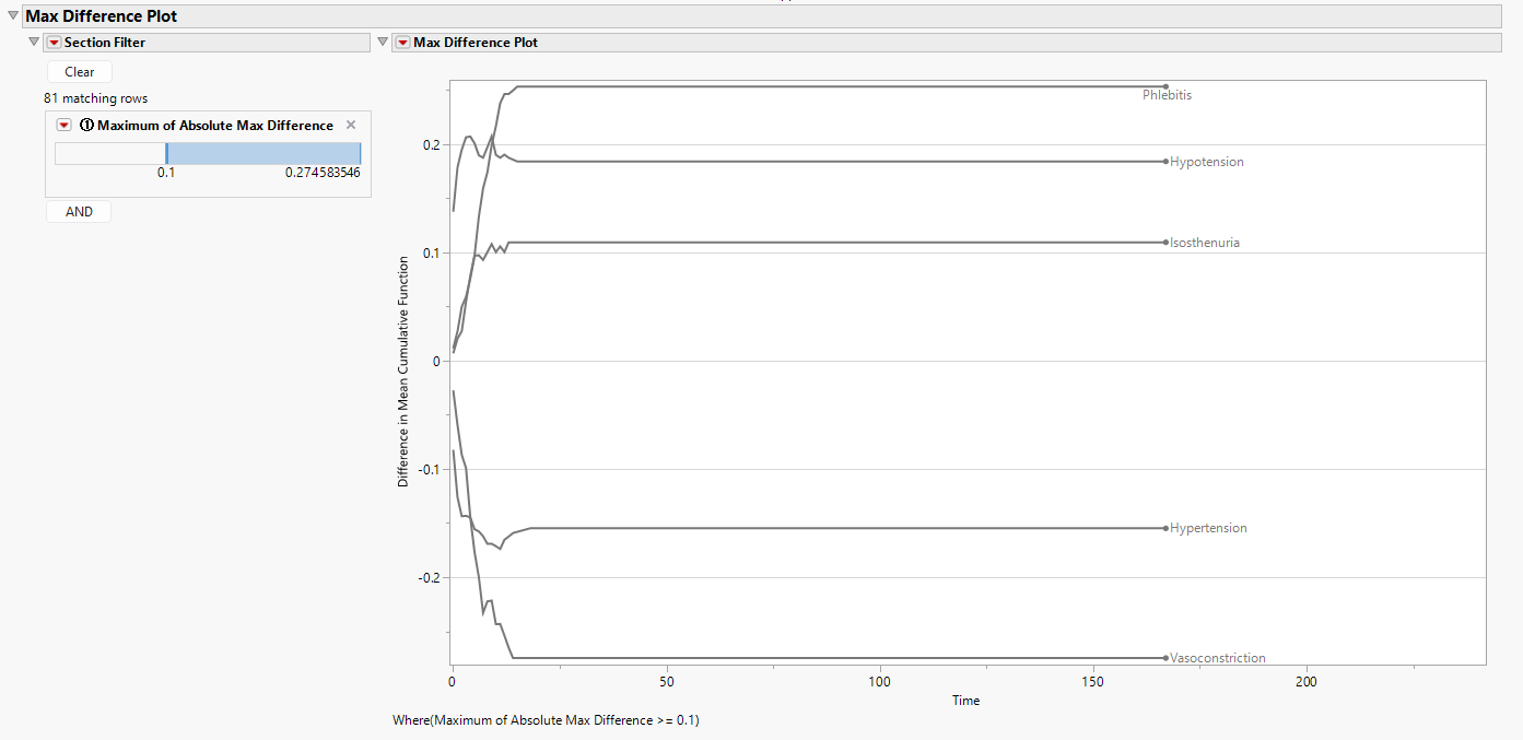

Max Difference Plot
While the Dot-Forest Plot is useful for identifying treatment differences among AEs at the end of follow-up (the minimum of the maximum of follow-up times), this ignores any differences that could be present earlier in the study. The Max Difference Plot (above) provides a summary of all AEs across the entire duration of the study as an alternative way to explore specific events in detail. Simply put, the Max Difference Plot takes the maximum observed value of the mean cumulative function (MCF) across all treatments and subtracts the minimum observed value of the MCF, thereby summarizing the maximum difference at each time point across all treatments. In this case, the minimum value of the y-axis would be 0 (since differences would always be positive). In the special case of two treatments, the Max Difference Plot communicates direction between the two treatments by taking the differences in the MCFs between the first treatment minus the second treatment. Effectively, this definition makes the plot similar to the Differences in Mean Cumulative Function Plot below, except here all AEs are presented. Note that this plot is not produced in the case where only a single treatment arm is available.
Summarizing all AEs across time within a single plot can be particularly crowded. To make the Max Difference Plot more interpretable, the Section Filter utilizes the Maximum of Absolute Max Difference to subset to the most interesting events. By default, this value is 10%, meaning that only AEs that experience at least a 10% difference among the treatments at least once over the course of the study are presented. For the Nicardipine study presented above, only 5 AEs meet this threshold. Phlebitis, Hypotension, and Isosthenuria show increased risk for Nicardipine (since the result is generally positive), while Hypertension and Vasoconstriction show increased risk for Placebo (since the result is generally negative).
Recall that for more than two treatments, the differences presented in the Max Difference Plot are the maximum differences observed across all pairs of treatments at any given time point. This enables the user to find AEs where large differences are occurring; subsetting to these interesting events will allow them to better understand the direction of these differences among the treatments across time.

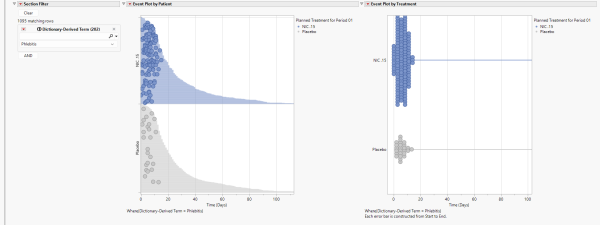

Event Plots
Event plots are produced to show when AEs occur across the follow-up time at the patient level (left) and treatment level (right).
Patients along the y-axis in the left hand plot are sorted according to the length of their follow-up time. The treatment-level event plot could be interpreted as the events occurring early and not beyond 13 days. However, this is due to a handful of participants with long follow-up times. As seen in the left hand plot, the phlebitis events occur pretty evenly across the follow-up time, particularly for the NIC.15 patients. Note that the bubble size is indicative of the number of events occurring at a given time. Should follow-up start and end dates not include a time component, larger bubbles would indicate multiple events occurring on a single day for a patient. This is less likely to occur when time is considered.
Note: For single arm studies, event plots are presented vertically to allow for greater visibility of the plots.

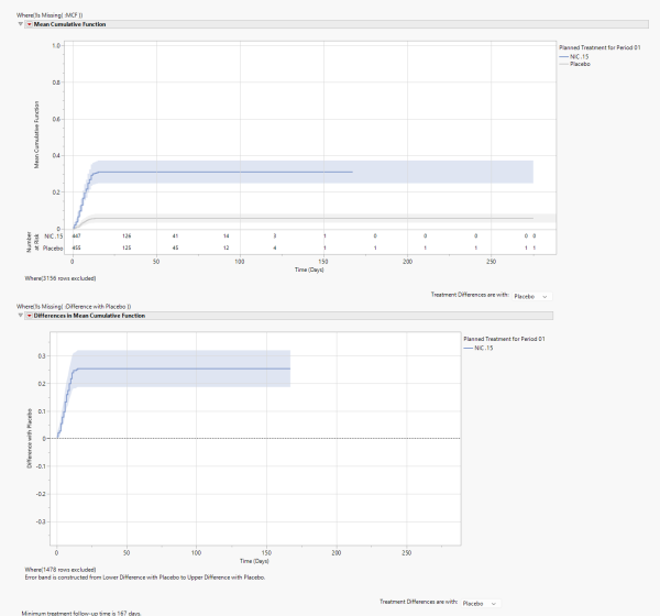

MCF Plot and Difference in MCF Plot
The top panel displays a plot of the MCF for each treatment and the pointwise 95% confidence band. The approximately straight line for the MCF (at least until about 13 days) shows that phlebitis AEs occur at a relatively constant rate over time. The MCF becomes horizontal beyond approximately 13 days indicating no additional phlebitis events occur.
The Number at Risk table, displayed at the bottom of the figure when All Patients is selected using the Number at Risk display option, communicates the number of patients who have yet to have an event or be censored. When Cumulative Events is selected using the Number at Risk display option, the total number of patients with events up to and including a particular time are presented in the risk table, which has now been renamed Cumulative Events. Numbers are presented every 30 days and at the last day of follow up.
Note: An MCF curve that is concave down would indicate that the time between phlebitis events is increasing, showing a decrease in phlebitis events. In other words, safety is improving for phlebitis events. An MCF curve that is concave up would indicate that the time between phlebitis events is decreasing, showing an increase in phlebitis events. In other words, safety is worsening for phlebitis events.
Note: For single arm studies, a Difference in Mean Cumulative Function plot is not applicable and is therefore not created.

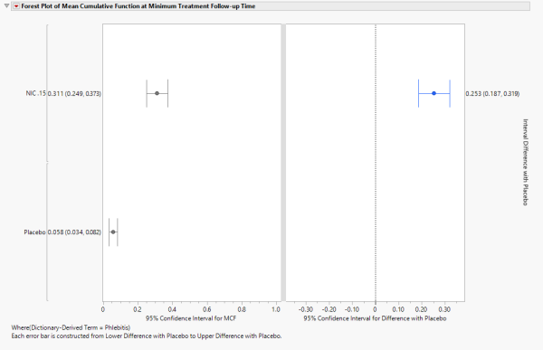

Forest Plots of MCF and Difference in MCF Confidence Intervals
The dual forest plot presents the 95% confidence intervals graphically and in text of the MCF for each treatment as well as the pairwise differences for MCF at the minimum treatment follow-up time. Like the plots shown above, the control group can be selected using the combo box. The points in the left forest plot correspond to the dot plot; here, the confidence intervals are presented to show additional information.

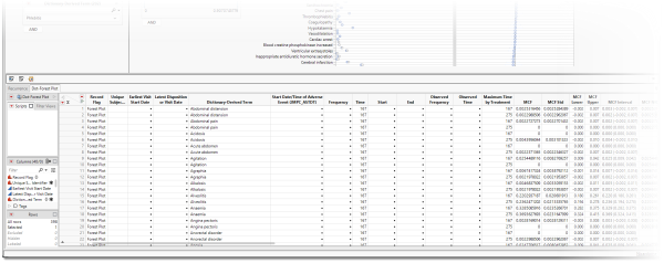

Data Tables
Finally, should additional analysis insight be of interest from the JMP Recurrence Analysis platform, the Recurrence data table where Record Flag equals Patient can be used.
8 Click to view the underlying data table.
8 Click to open the data table as a JMP table.

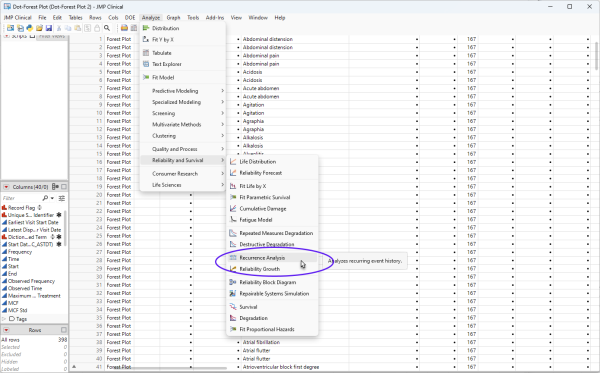

8 Select Analyze > Reliability and Survival > Recurrence Analysis to open the Recurrence Analysis platform.
8 Set the following options:
• Y, Age, Event Timestamp will use the start date of the adverse event.
• Label will use Unique Subject Identifier.
• Cost will use Frequency.
• Grouping will use Treatment.
• Timestamp at Start/End will use the dates.
• By will use event name, typically Dictionary-Derived Term if analyzing preferred terms.
8 Continue the analysis in JMP as described in the Recurrence Analysis platform documentation.
