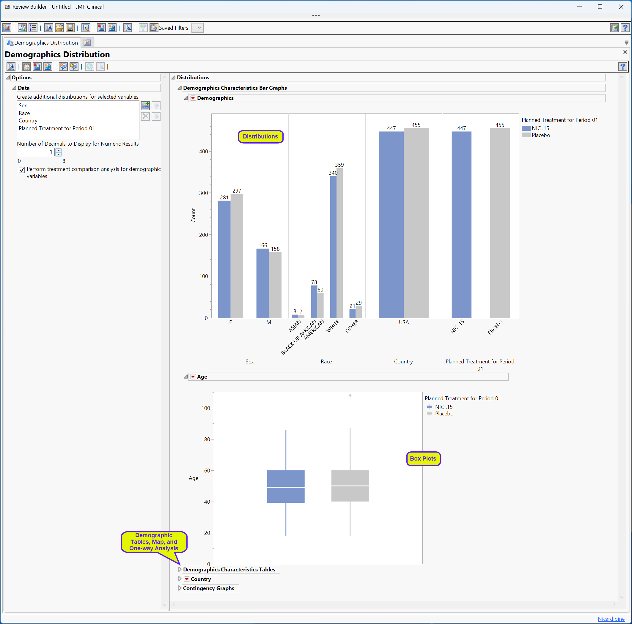

The Demographics Distribution report initially shows two sections Demographic Characteristics and Distributions.
Distribution and Box Plots
Presents histograms for available demographic characteristics such as age, treatment, sex, race, and country, by default. Click in the Options panel to add additional histograms.
This section contains the following elements:
• One or more histograms.
The height (or length) of each bar is an indication of the number of subjects exhibiting each demographic characteristic.
You can change how your data are presented in the histograms using the Histogram Options, which can be viewed by clicking for each set of histograms and selecting Display Options.
Quantiles and summary statistics are provided for continuous variables like Age, and frequencies are provided for categorical variables like Sex. These can be viewed by clicking for each set of histograms and selecting Display Options.
See Distribution for more information.

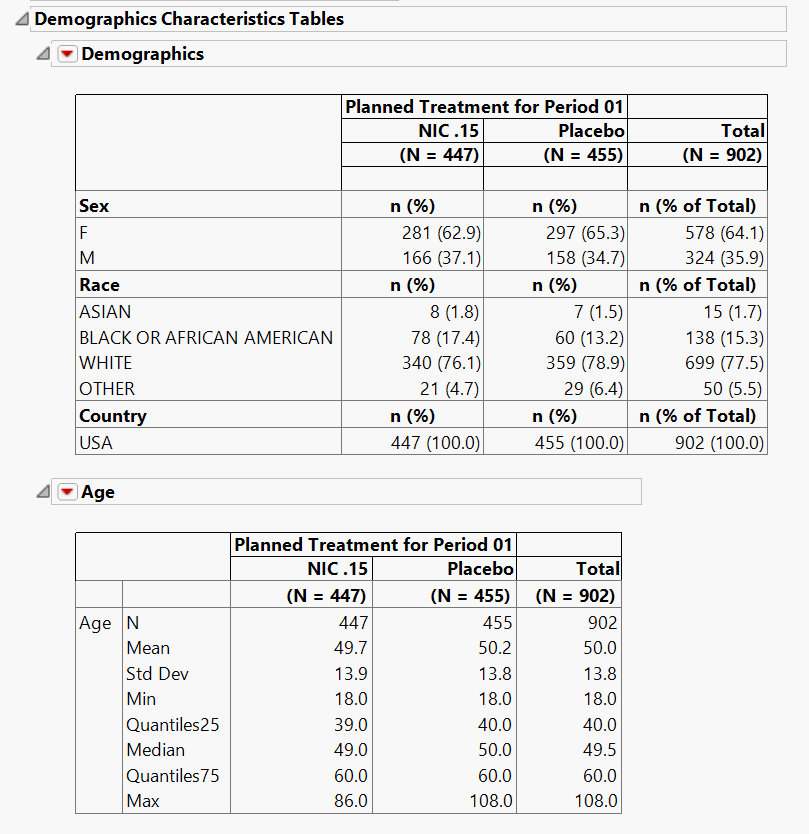

Demographics Characteristics
Presents tables showing how the subject cohort breaks down by sex, race, and country by treatment group and age.

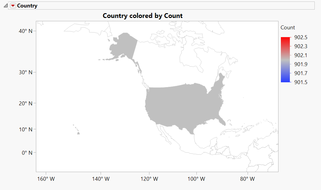

Map
Displays a map showing the countries where the study subjects are located.

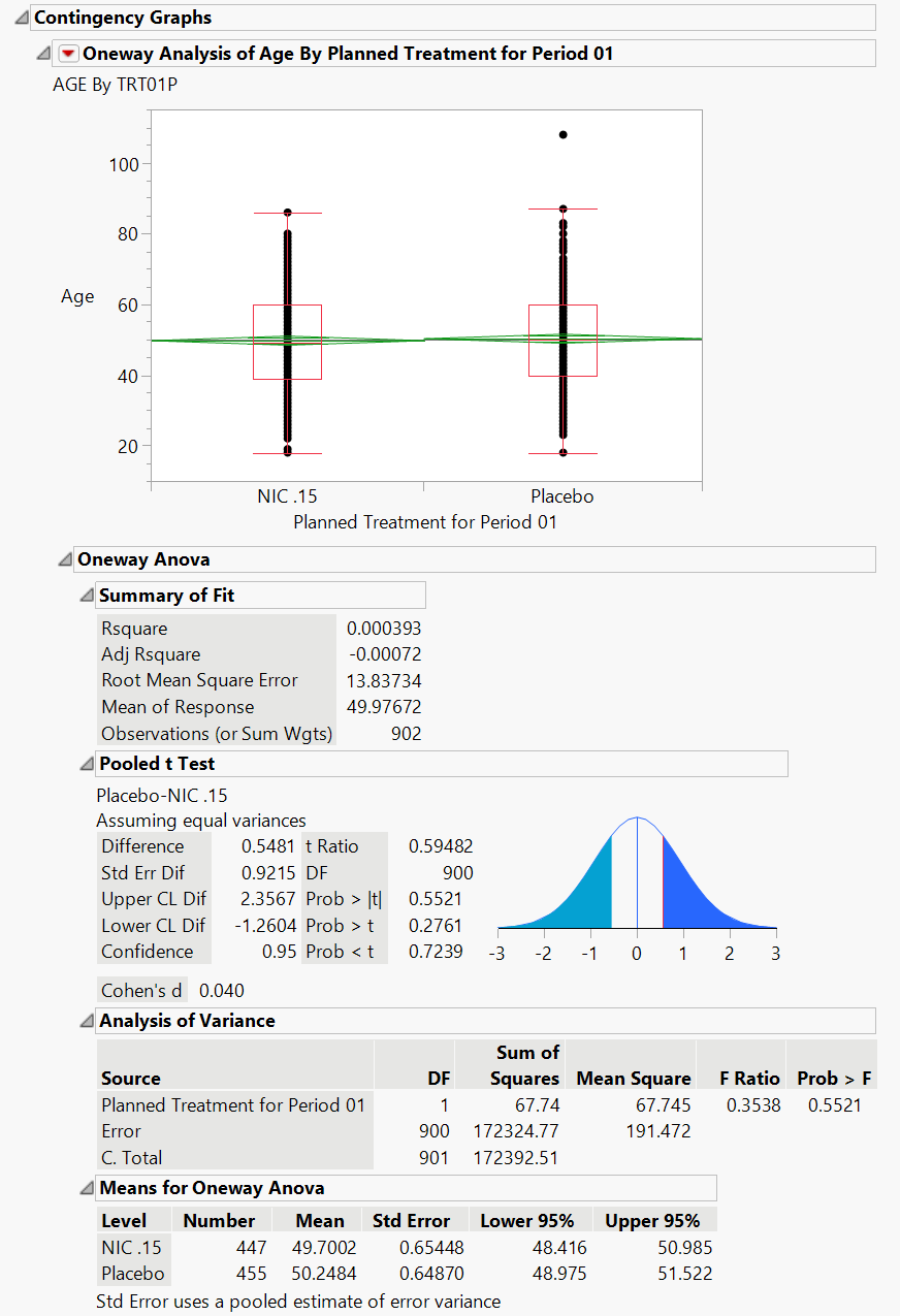

This report performs a one-way ANOVA (analysis of variance) to detect statistical differences for continuous demographic variables (e.g. Age) and contingency analyses for character/categorical variables (e.g. sex, race, and study site) by the treatment variable specified in the Options panel.
The One-way Plot above shows the distribution of subjects by age for each of the two treatment arms. The analysis statistics are listed in the tables below the plot.

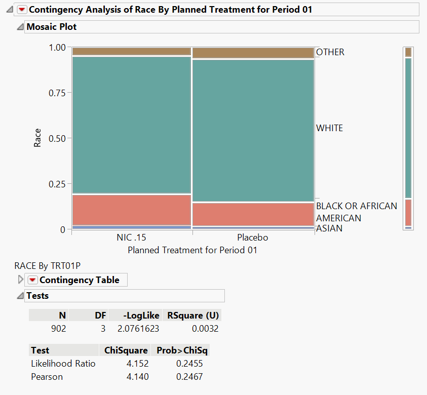

The Mosaic Plots for sex and race by treatment arm are graphical representations of a two-way frequency table or contingency table (shown below their respective plots), divided into colored rectangles. There is one rectangle for each demographic group for each treatment arm. The area of each rectangle is proportional to the proportions of each demographic group in each treatment arm.

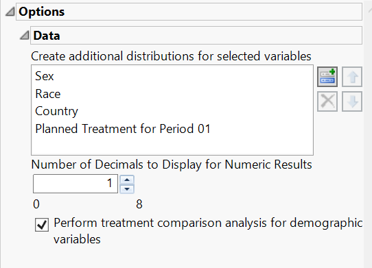

Options
This panel enables you to select the demographic variables used to create distributions, specify the number of decimal places to display and perform treatment comparison analysis for the demographic groups.
Create additional distributions for selected variables
This option enables you to add or remove demographic variables from DM from the distributions.
8 Click to open the Add window shown below:
8 Select one or more variables and click
8 To remove one or more distributions, highlight the variables to be deleted and click .
8 To rearrange the order of the distributions, select a variable and click either or .
Number of Decimals to Display for Numeric Results
Use this option to specify the number of decimals to include in the plots and tables of numerical results.
Perform treatment comparison analysis for demographic variables
Check this box to generate the treatment comparisons shown above.
