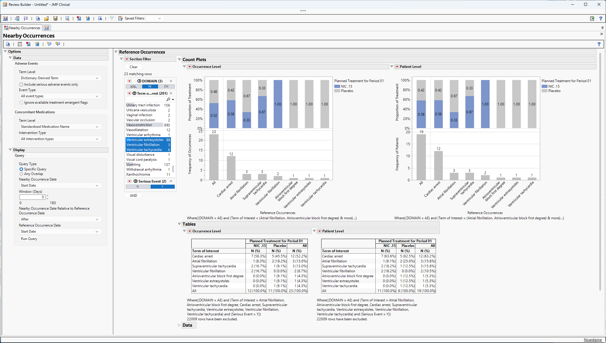

Reference Occurrences
This section includes two count plots and the associated tables, shown below.
Note the selections in the section filter.
From the left Count Plot at the occurrence level, we can ascertain the following:
• There are 23 reference occurrences that are SAEs from the HLGT cardiac arrhythmias. Of these 23 occurrences, 52% and 48% of these events take place in patients in the NIC .15 and Placebo arms, respectively.
• The most commonly occurring event is cardiac arrest with 12 occurrences, 58% and 42% in NIC .15 and Placebo, respectively.
• The least common SAE cardiac arrhythmias are atrioventricular block first degree, ventricular extrasystoles, and ventricular tachycardia with 1 occurrence each which occurred in patients in the placebo arm.
From the right Count Plot at the patient level, we can ascertain the following:
• There were 19 patients that experienced cardiac arrhythmia SAEs. Of these 19 patients, 58% and 42% are in the NIC .15 and Placebo arms, respectively.
• The frequencies of patients for each occurrence type (n = 12, 3, 3, 2, 1, 1, 1) do not change from the occurrence level Count Plot, indicating that each occurrence type occurs in a different patient. Had the frequencies been higher for an occurrence type in the occurrence level plot, that would have indicated that patients would have experienced more than one instance of an occurrence.
• The sum of the frequencies of the individual occurrences (12 + 3 + 3 + 2 + 1 + 1 + 1 = 23) is greater than the number of patients (n = 19), indicating that some patients experienced multiple cardiac arrhythmia SAEs.
Tabular summaries are provided that show the frequency and column percentage of each occurrence. For example, from the tables we can conclude that:
• 52.2% (12/23) of the cardiac arrhythmia SAE occurrences across both arms were cardiac arrest.
• 63.2% (12/19) of the patients with at least one cardiac arrhythmia SAE occurrence experienced a cardiac arrest.
The 23 reference occurrences are available for review by opening the Data outline box (not shown).

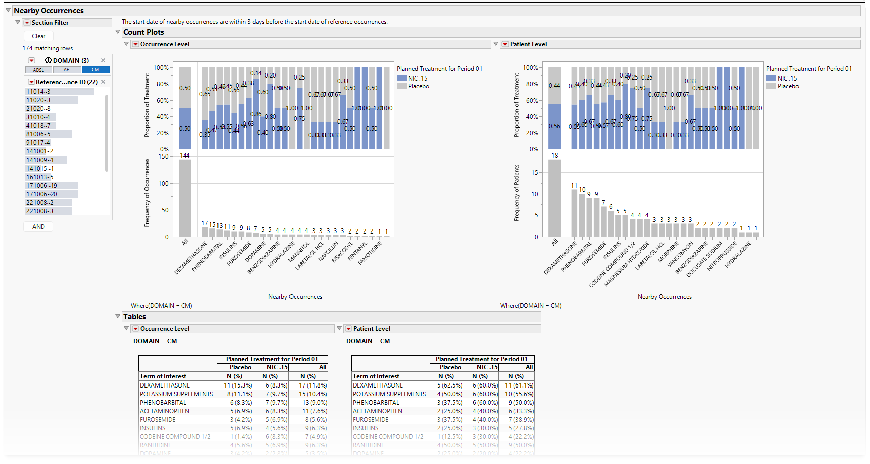

Clicking Run Query will produce figures and tables in the Nearby Occurrences area of the output window (shown below). You can close the Reference Occurrences outline box to easily view this output.
The initial output is extremely crowded, though when we subset to CM using the Section Filter, we get the results shown below:
Based on the results, the following is true:
• Occurrence Level
• There are 260 CM occurrences that are nearby to the 23 SAEs from the HLGT cardiac arrhythmias. Of these 181 CM occurrences, 51% and 49% of these CM occurrences take place in patients in the NIC .15 and Placebo arms, respectively.
• The most common nearby CM occurrence is dexamethasone with 17 occurrences, 35% and 65% in NIC .15 and Placebo, respectively.
• Phenobarbital (visible when the graphic is enlarged) has 13 occurrences.
• 15% of all nearby CM occurrences were potassium supplements.
• Patient Level
• All 19 patients identified based on reference occurrences have nearby CM occurrences for the 23 SAEs from the HLGT cardiac arrhythmias.
• Nine patients had phenobarbital (and given there are 13 instances at the occurrence level, some patients had it more than once in those 3 days). Ten patients had potassium supplements (and given there are 15 instances at the occurrence level, some patients had it more than once in those 3 days).
• 47.4% of patients had phenobarbital, evenly distributed between NIC.15 and the placebo.

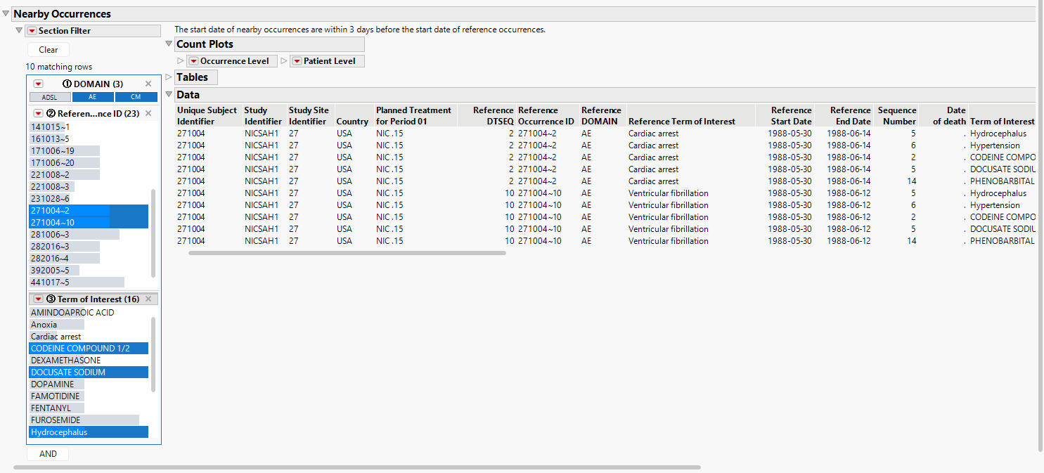

Here, the Data window may be of more interest to the user to see the details for nearby occurrences. Note that the figures and tables shown above display unique nearby occurrences. However, the Data window will show all of the nearby occurrences that are appropriate for each reference occurrence, even if the nearby occurrences are presented multiple times.
For example, the figure below shows (all) nearby occurrences for patient 271004. The same 2 AEs are shown for each reference occurrence (one cardiac arrest and one ventricular fibrillation). This is to help indicate the specific occurrence that corresponds to each reference occurrence. Note that the user can subset to each reference ID in the data filter for ease of review.
The report will still include reference occurrences in the output even when no nearby occurrences are present. The easiest way to observe these instances (if they occur) is to select the missing domain in the data filter.

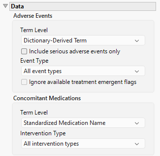

Data
Term Level
Term Levels are determined by the coding dictionary for the Event/Intervention domain of interest, typically these levels follow the MedDRA dictionary. Use this widget to specify how each adverse event is named and the level at which the event is considered. For example, selecting Reported Term for the Adverse Event reports the event specified by the actual event term as reported in the AE domain. Refer to Term Level for more information.
Include serious adverse events only
By default, all events are included in the analysis. However, you can opt to include only those considered serious. Checking the Include serious adverse events only widget restricts the analysis to those adverse events defined as Serious under FDA guidelines.
Event Type
Analysis can consider all events or only those that emerge at specific times before, during, or after the trial period. For example, selecting On treatment events as the Event Type includes only those events that occur on or after the first dose of study drug and at or before the last dose of drug (+ the offset for end of dosing).
Ignore available treatment emergent flags
If you choose to ignore available treatment emergent flags, the analysis includes all adverse events that occur on or after day 1 of the study.
Term Level
Term Levels are determined by the coding dictionary for the Event/Intervention domain of interest, typically these levels follow the MedDRA dictionary. Use this widget to specify how each intervention is named and the level at which the intervention is considered.
Intervention Type
Analysis can consider all interventions or only those that occur at specific times before, during, or after the trial period. For example, selecting On treatment events as the Intervention Type includes only those interventions that occur on or after the first dose of study drug and at or before the last dose of drug (+ the offset for end of dosing).

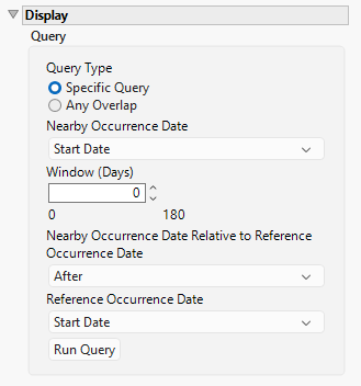

Use this option to specify the type of query to run. Options include:
Specific Query
This query will search for nearby occurrences by comparing the Start/Stop date of the reference occurrences to the Start/Stop of the nearby occurrences. If the nearby occurrences occur within the selected number of days after, before, or before or after the selected dates, they will be summarized in the Nearby Occurrences area of the output. Note that a window of 0 days will identify occurrences that occur on the same date.
Any Overlap
This query will search for nearby occurrences by assessing whether there is any overlap in time based on the start and end dates of the reference and nearby occurrences.
Nearby Occurrence Date
Use the drop-down menu to select the nearby occurrence date to use. Options include the start date or the end date of the study.
Window (Days)
Use this option to set the size of the time window with which an occurrence must take place relative to the reference occurrence to be considered "nearby".
Nearby Occurrence Date Relative to Reference Occurrence Date
Use the drop-down menu to select the time the nearby occurrence happens relative to the reference occurrence. Options include before the reference occurrence, after the reference occurrence, or both before and after.
Use the drop-down menu to select the reference occurrence date to use. Options include the start date or the end date of the study.
