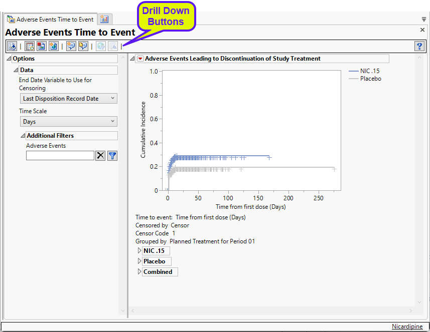

Report Results Description
Running this report with the Nicardipine sample setting generates the tabbed Results shown below.
This report presents a plot and several tables.
Cumulative Incidence Plot
This plot shows the cumulative incidence of adverse events over the time elapsed from the first treatment dose. Examination of this plot enables one to see when the events occurred and gives an accurate estimate of the incidence by treatment group. Subjects are censored at the date of the last disposition record unless another date is chosen.

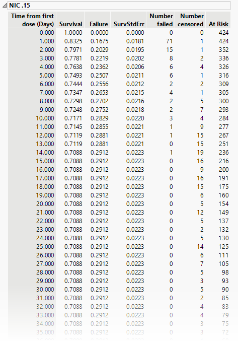

Tables
Tables provide basic statistics for each treatment group and for the overall study. The table below shows the results for the Nicardipine treatment group.
The tables list time from the first dose and, at each time point, both survival in the trial and failure to continue, absolute number failed or censored and the number remaining at risk.
Options
Data
End Date Variable to Use for Censoring
Use the End Date Variable to Use for Censoring option for specifying the end date for censoring. Options include the reference end date, date of the last treatment, or the date of the last disposition record (selected by default).
Time Scale
Use this widget to specify the time scale to use for times. Options include Hours, Days, Weeks, Months, and Years. Refer to Time Scale for more information.
Additional Filters - Adverse Events
This filter lets you restrict your analysis to only those subjects that meet specific criteria at the AE domain level. See Adverse Events for more information.
Note: To filter subjects with a specific event or finding, one could also use the Subpopulation Builder on any domain of interest. For example, filter to all subjects that exhibit cardiac failure ( :Customized Query 01 Name == "Cardiac failure" ) and run all reports on those.
• Click to rerun the report using default settings.
• Click to view the associated data tables. Refer to Show Tables for more information.
• Click to generate a standardized PDF- or RTF-formatted report containing the plots and charts of selected sections.
• Click to generate a JMP Live report. Refer to Create Live Report for more information.
• Click to take notes, and store them in a central location. Refer to Add Notes for more information.
• Click to read user-generated notes. Refer to View Notes for more information.
• Select one or more subjects, then click to apply the Review Subject Filter and filter all reports in the review builder on the selected subjects.
• Select a group of subjects and click to specify Derived Population Flags that enable you to distinguish the selected group of subjects from the general population.
