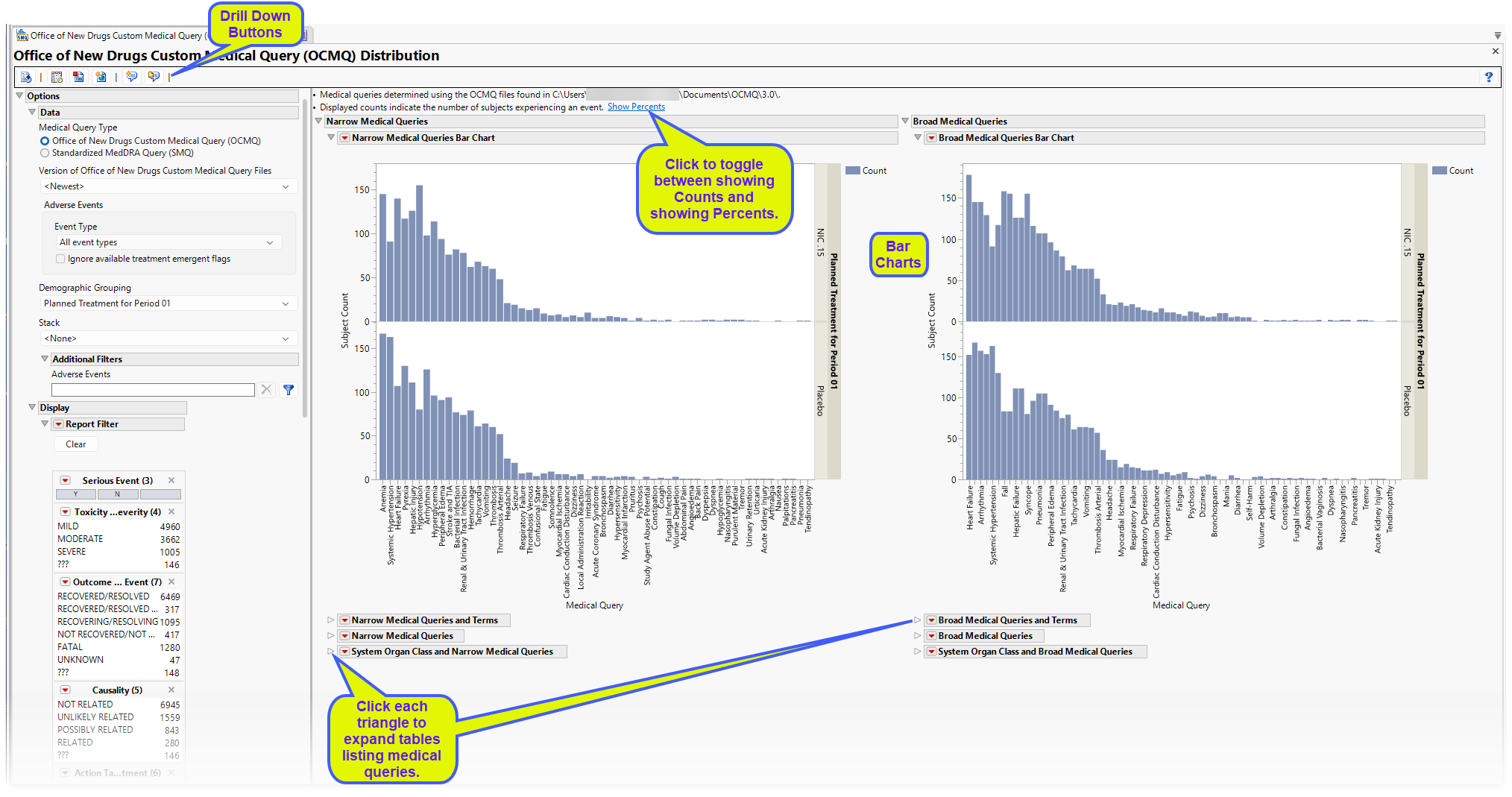

Running Medical Queries Distribution for the Nicardipine study using Office of New Drugs Custom Medical Queries (OCMQs) (v3.0) files generates the Report shown below.
Note: Your output might vary depending on which version of OCMQs or MedDRA you provide.
The Report contains the following elements:
Narrow and Broad Medical Query Results
The Narrow Medical Queries and Broad Medical Queries sections each present the following:
• A set of Bar Charts (shown above).
Bar charts are provided to summarize the frequency or percentage of subjects with each medical query.
Narrow search uses a more specific set of adverse event terms to identify a possible medical condition, while broad search uses a larger set of terms that could indicate a safety signal.

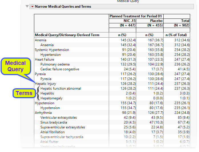

The Medical Queries and Terms table lists the counts (and percentages) by treatment arm for each medical query and the specific preferred terms associated with each query.

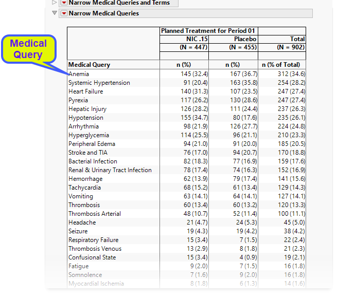

The Medical Queries table lists the counts (and percentages) by treatment arm for each medical query (no terms).

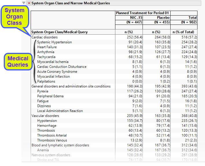

The System Organ Class and Medical Queries table organizes the results by system organ class and lists the counts (and percentages) by treatment arm for each system organ class and further by their associated medical queries.

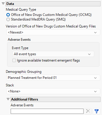

Data
Use the drop-downs on this panel to customize your analysis.
Medical Query Type
This widget enables you to specify whether you are using the Office of New Drugs Custom Medical Queries (OCMQs) or standard medical queries (SMQs). OCMQs are used by default. Refer to Medical Query Type for more information. If SMQs are selected, then the AE dataset from the study will be joined with the MedDRA ASCII files to map each AE to the associated medical queries. If the OCMQs are selected, then the AE dataset from the study will be joined with the OCMQ Excel file to map each AE to the associated medical queries.
Version of Office of New Drugs Custom Medical Query Files/Version of Standardized Medical Query Files
Use this widget to specify the version of the Medical Query files to use in the analysis. Options include all of the Medical Query files stored in the Medical Query directory specified for your configuration. Refer to General File Paths for information about the location of this directory. This option is dependent on the medical query type specified above.
Event Type
Analysis can consider all events or only those that emerge at specific times before, during, or after the trial period. For example, selecting On treatment events as the Event Type includes only those events that occur on or after the first dose of study drug and at or before the last dose of drug (+ the offset for end of dosing).
Ignore available treatment emergent flags
If you choose to ignore available treatment emergent flags, the analysis includes all adverse events that occur on or after day 1 of the study when the event type is Treatment emergent events.
Demographic Grouping and Stack
Results can be viewed as a whole or they can either be split out by Demographic Grouping or Stacked to show different levels within each event. Demographic Grouping will change the variable displayed on the y-axis of the bar chart, as well as change the variable used across the top of the table to split the columns. Stack impacts the bar chart by stacking the bars according to the levels of the chosen variable with corresponding effects in the table. For example, if severity is chosen, the bars will be stacked by mild, moderate, and severe events.
Additional Filters - Adverse Events
This filter lets you restrict your analysis to only those subjects that meet specific criteria at the AE domain level. See Adverse Events for more information.

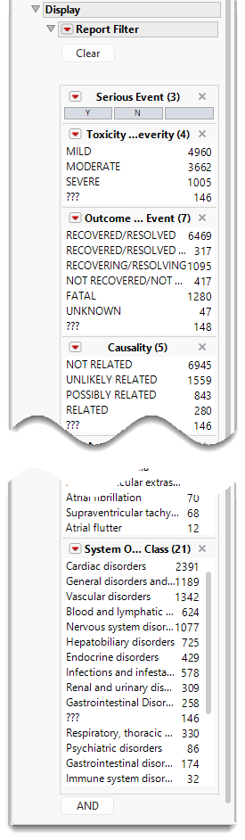

Report Data Filters
These filters enable you to subset and view subjects based on demographic characteristics and other criteria. Refer to Data Filter for more information.
Note: Filter specifications are reapplied when any widget options are changed.
