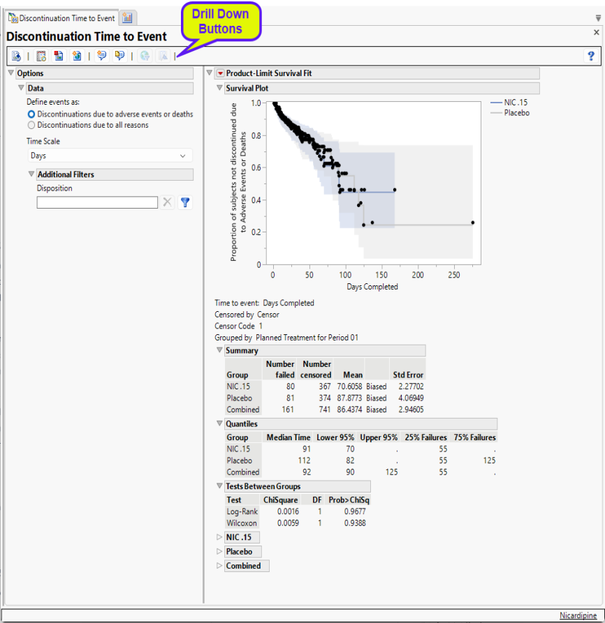

This report creates a plot that displays the proportion of subjects who have not discontinued the study by days completed. Discontinuation events can be limited to those due to adverse events or deaths only (default) or those due to all reasons.
Report Results Description
Running this report for Nicardipine using default settings generates the tabbed Results shown below.
Results
Contains a Kaplan-Meier Survival Curve time-to-event analysis that compares the time until discontinuation of individuals in each treatment arm in the study. Otherwise, subjects are censored when they complete the trial. You can define what constitutes a discontinuation using the Define events as: option in the Discontinuation Time to Event.

Define events as:
A patient may drop out of a study, or discontinue, because of a variety of reasons. It is important to consider reasons for patient's discontinuation in a study while assessing the outcome of any study. Discontinuations directly resulting from adverse events or death arising from study protocols must absolutely be considered. Others, however, are not relevant to the outcome. For example, relocation of a patient to a different city could cause the patient to discontinue, but would not be significant and can safely be excluded from the analysis. You can use the Define events as: option to differentiate between these events.

Discontinuations are determined using the last record per subject where the disposition category is "Disposition Event." When the option for "Define events as:" is set to Discontinuations due to adverse events or deaths, disposition terms of "DEATH", "DEAD", "DIED" and "ADVERSE EVENT" are all considered discontinuations. When the option is set to Discontinuations due to all reasons, then any disposition event not listed as "COMPLETE" or "COMPLETED" is considered a discontinuation. If a subject does not experience a discontinuation event, they are censored at the date of the last disposition event. If a disposition event does not exist for a subject, then the censor date is set to the last treatment date (TRTSDT) or the reference end date (RFENDTC). Any subjects with a missing disposition date and missing censor date are removed from the analysis and a note will appear at the top of the report to indicate subjects have been removed.
