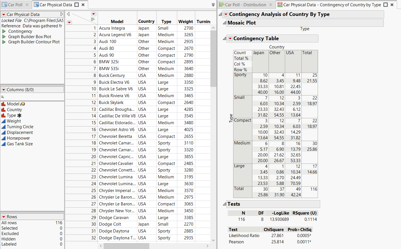

If you are constantly opening the same related files and reports, saving them to a project file is a quick way to reopen and access them in one place. You can also share the project file with other JMP users.
Figure 11.21 Project File with Data Tables and Reports
