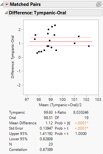

The Matched Pairs report shows a Tukey mean-difference plot, summary statistics, and the results of the paired t test. See Difference Plot and Report. If you specified an X, Grouping variable, the report also includes the Across Groups report. See Across Groups.
Figure 20.4 Example of Matched Pairs ReportĀ
