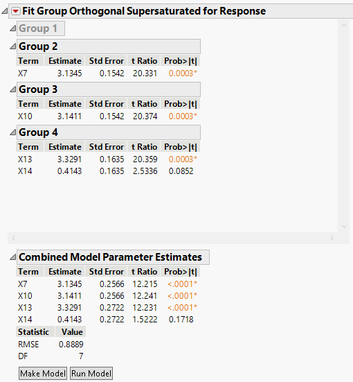

Use the Fit Group Orthogonal Supersaturated platform to analyze group orthogonal supersaturated designs. This analysis technique takes advantage of the group orthogonal structure of group orthogonal supersaturated designs.
Figure 27.1 Fit Group Orthogonal Supersaturated ResultsĀ
