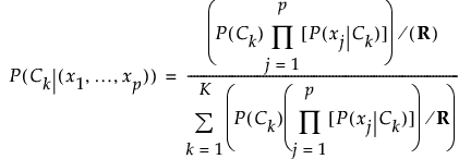

The conditional probability that an observation with predictor values x1, x2, …, xp belongs in the class Ck is computed as follows:
Equation shown here,
where R is a regularization constant. In the formula above, the conditional probability that an observation with Xj = xj belongs to the class Ck, P(xj|Ck), is determined as follows:
