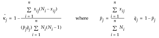

Categorical Kappa statistics (Fleiss 1981) are found in the Agreement Across Categories report.
Given the following assumptions:
n = number of parts (grouping variables)
m = number of raters
k = number of levels
ri = number of reps for part i (i = 1,...,n)
Ni = m x ri. Number of ratings on part i (i = 1, 2,...,n). This includes responses for all raters, and repeat ratings on a part. For example, if part i is measured 3 times by each of 2 raters, then Ni is 3 x 2 = 6.
xij = number of ratings on part i (i = 1, 2,...,n) into level j (j = 1, 2,...,k)
The individual category Kappa is defined as follows:
Equation shown here

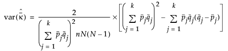

The variance of Equation shown here and Equation shown here are calculated as follows:
Equation shown here
Equation shown here
The standard errors of Equation shown here and Equation shown here are shown only when there are an equal number of ratings per part (for example, Ni = N for all i = 1,…,n).
