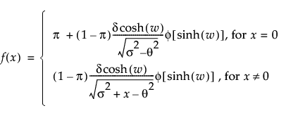

Fit ZI SHASH
The Fit ZI SHASH option fits a zero-inflated (ZI) sinh-arcsinh (SHASH) distribution. The zero-inflated SHASH distribution is equivalent to a SHASH distribution with a point mass at zero. It can be symmetric or asymmetric.
pdf: Equation shown here for Equation shown here; 0 < δ, σ
where
Equation shown here is the standard normal pdf
Equation shown here
Note: Confidence intervals for ZI SHASH distribution parameter estimates use Wald-based calculations.
