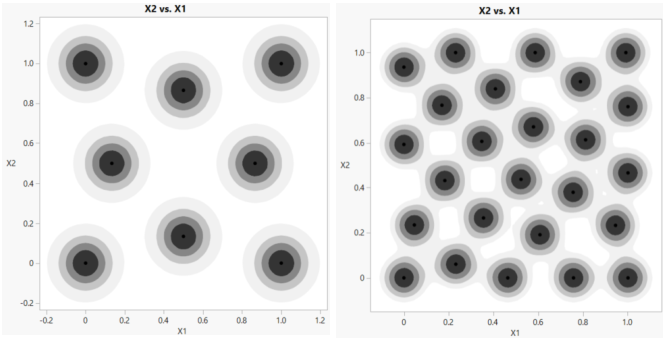

The Space Filling platform provides multiple design types for situations with only continuous factors. A special design type exists for designs that include categorical, discrete numeric or mixture factors. For continuous factors, space-filling designs have two objectives:
maximize the distance between any two design points
space the points uniformly
Figure 21.1 Space-Filling Design
