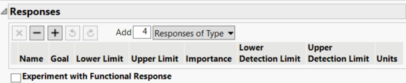

Figure 12.11 Responses Outline
Responses Outline
Response Buttons

Add N Responses of Type
Enables you to add a specified number of responses for a specific goal. First, specify the number of responses to add, then use the Responses of Type drop-down menu to specify the goal for the responses.
The Responses outline contains the following columns:
Name
The name of the response. When added, a response is given a default name of Y, Y2, and so on. To change this name, click it and enter the desired name.
Goal
The goal for the response. Use the drop-down menu to specify if you want to maximize or minimize your response, match a target, or that you have no goal for your response. Based on these specifications, JMP assigns a Response Limits column property to each response column in the design table. It uses this information to define a desirability function for each response. The Profiler and Contour Profiler use these desirability functions to find optimal factor settings. For more information, see Desirability Profiling and Optimization in Profilers and Response Limits.
Lower Limit, Upper Limit
The lower and upper limits associated with the response. The limits are used in the desirability function based on the goal for the response.
A Goal of Maximize indicates that the best value is the largest possible value. If there are natural lower or upper bounds, you can specify these values as the Lower Limit or Upper Limit.
A Goal of Minimize indicates that the best value is the smallest possible value. If there are natural lower or upper bounds, you can specify these values as the Lower Limit or Upper Limit.
A Goal of Match Target indicates that the best value is a specific target value. The default target value is assumed to be midway between the Lower Limit and Upper Limit values.
A Goal of None indicates that there is no goal in terms of optimization. If this option is selected, no desirability function is constructed.
Note: If your target response is not midway between the Lower Limit and the Upper Limit, you can change the target after you generate your design table. In the data table, select Cols > Column Info to open the Column Info window for the response column, and enter the desired target value.
Importance
The importance of the response. When you have several responses, the Importance values that you specify are used to compute an overall desirability function. These values are treated as weights for the responses. If there is only one response, then specifying the Importance is unnecessary because it is set to 1 by default.
Image shown hereDetection Limits
The lower and upper detection limits are bounds beyond which the response cannot be measured. The detection limits are saved as a column property. You can use these limits to specify a censored response in either the Distribution or Generalized Regression platform. See Censoring in Fitting Linear Models.
Units
The experimental units for the factors. To specify units for a response, click and enter the appropriate units.
