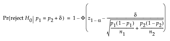

The power calculations for testing the difference in proportions from two sample groups are based on the normal approximation. The calculations depend on the form of the alternative hypothesis. For a one-sided, higher alternative (p1 > p2):
Equation shown here

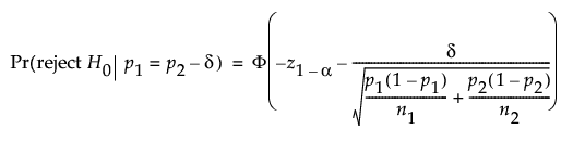

For a one-sided, lower alternative (p1 < p2):
Equation shown here

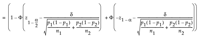

For a two-sided alternative (p1p2):
Equation shown here
Equation shown here
