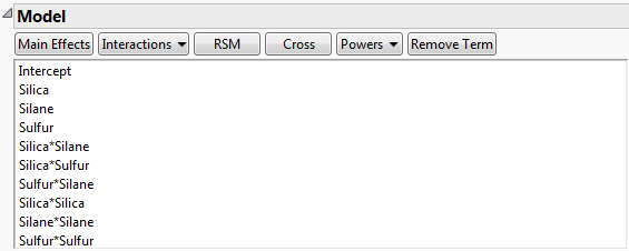

In the Evaluate Design report, the initial entries in the Model section depend on whether the associated data table contains a Model or Fit Model script:
If there is a script, the Model section contains the estimable effects specified in the script. Effects are entered into the model in the order specified in the script. If the model script contains more effects than are estimable, those that are not estimable are not included in the model for evaluation.
If there is no script, the Model section contains only main effects.
Figure 16.6 Model for Bounce Data.jmp
