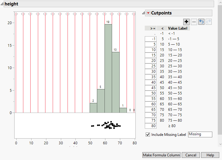

Example of Making a Binning Formula
1. Select Help > Sample Data Folder and open Big Class.jmp.
2. Select the height column.
3. Select Cols > Utilities > Make Binning Formula.
You want the range of values to appear as X-X, so in the Bin Label Style, keep the range set to Low - High.
4. Click the Cutpoints red triangle and select Fill using Equal Width Bins.
5. In the window that appears, change the offset to -0.5.
Tip: For integer data, setting the offset to -0.5 helps disambiguate values on the edge. In this example, one of the bins covers 59.5 to 64.5, so it is clear that 59 and 65 are not included in this bin.
6. Keep the width set to 5.
7. Click OK.
8. Keep the Bin Label setting of Use Value Labels so that you can see the range of values for the bin.
Figure 4.39 Completed Binning Window
9. Click Make Formula Column.

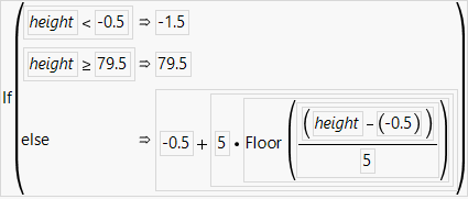

A column called height Binned is added to the Big Class.jmp data table.
10. To see how the formula is calculated, right-click the height Binned column and select Formula.
Figure 4.40 Formula
Formula
