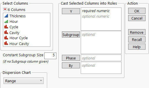

Figure 3.5 Launch Window for Variable Control Charts
Y
Assigns the process variables.
Subgroup
(Not available for Run charts.) Assigns the subgroup variables. When a subgroup variable is assigned, each point on the control chart corresponds to a summary statistic for all of the points in the subgroup.
Product/Part
(Available only for Short Run charts.) Assigns the Product/Part variable. When a Part variable is assigned, statistics are calculated for each product, or level of the Part variable. These statistics are used to calculate the control limits.
Label
(Not available for XBar, IMR on Means, or Three Way Control Charts.) Assigns a sample label variable to uniquely label individual measurements. The labels are not sorted and appear on the horizontal axis in the same order they appear in the data table.
Note: If a subgroup size greater than one is specified by a Subgroup variable, a constant subgroup size, or the Set Subgroup Size command in a script, the Label variable is ignored.
Phase
(Not available for Run charts.) Assigns the phase variable. When a Phase variable is assigned, separate control limits are computed for each phase.
Note: If there is a spec limits column property, by default, the same specification limits are used for each phase. However, no capability analysis is shown.
By
Identifies a variable to produce a separate analysis for each value that appears in the column.
Sort by Subgroup
(Available only for IMR charts.) Sorts all Y variables by the Subgroup variable.
Show Center Line
(Available only for Run charts.) Shows the center line on the chart.
Constant Subgroup Size
(Available only for XBar and Three Way charts.) Specifies a number of observations that make up each subgroup. If the number of observations per subgroup is not constant, you should specify a column in the Subgroup role.
Note: If you specify a Subgroup variable, the platform ignores the setting for the Constant Subgroup Size option.
Dispersion Chart
(Available only for XBar charts.) Specifies the type of dispersion chart that appears below the XBar chart. You can choose between no dispersion chart, a range chart (XBar & R), or a standard deviation chart (XBar & S).

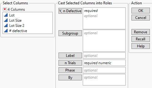

Figure 3.6 Launch Window for Attribute Control Charts
Y, n Defective
(Available only for P, NP, and Laney P control charts.) Assigns the process variables.
Y, n Defects
(Available only for C, U, and Laney U control charts.) Assigns the process variables.
Subgroup
Label
n Trials
Assigns the subgroup sample size.
Phase
By

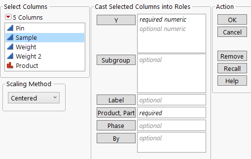

Figure 3.7 Launch Window for Short Run Control Charts
Y
Subgroup
Label
Product/Part
Phase
By
Scaling Method
Specifies the scaling method for the control chart. The options are Centered and Standardized.

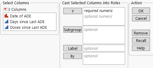

Figure 3.8 Launch Window for Rare Even Control Charts
Y
Subgroup
Label
By
