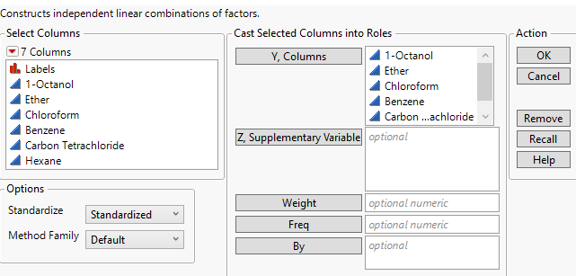

Launch the Principal Components platform by selecting Analyze > Multivariate Methods > Principal Components. Principal Component analysis is also available using the Multivariate and the Scatterplot 3D platforms.
The example described in Example of Principal Component Analysis uses all of the continuous variables from the Solubility.jmp sample data table.
Figure 4.3 Principal Components Launch Window
Y, Columns
The variables to analyze for components.

Standardize
Specifies whether each column is centered and standardized. This determines what matrix is used to calculate the principal components.
Standardized
Centers and standardizes each column individually. The principal components are calculated based on the correlation matrix.
Unscaled
Centers each column individually. The principal components are calculated based on the covariance matrix.
Unscaled and Uncentered
The principal components are calculated based on the unscaled and uncentered matrix.
