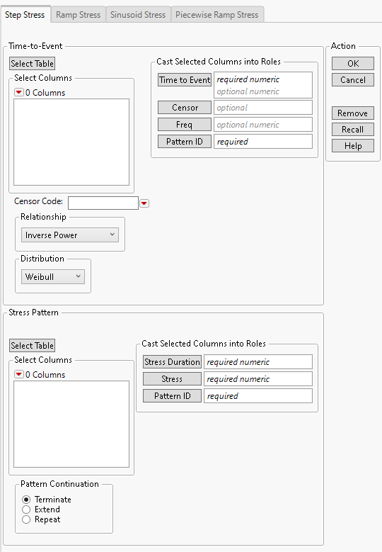

Launch the Cumulative Damage platform by selecting Analyze > Reliability and Survival > Cumulative Damage. You must specify two data tables in the launch window. The first data table is time-to-event data for each unit under test. The second data table defines the stress patterns used for each unit.
Figure 5.5 The Cumulative Damage Launch Window
The launch window includes a separate tab for each step-stress data format. For more information about the various stress patterns, see Stress Pattern.
Each of the step-stress format tabs contains two panels for specifying variables for the model:
The Time-to-Event panel is common to all of the step-stress formats. This panel is similar to the Fit Life by X platform launch window.
The Stress Pattern panel is used to describe the type of stress. Consequently, its format depends on the selected step-stress tab.
