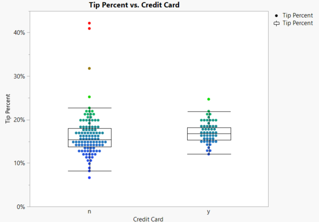

Figure 13.3 Graph Builder For Tip Percentage by Credit Card Type
6. To confirm that the graph is complete, close the Graph Builder window.
Note: The step named Launch platform: Graph Builder is replaced with a Report snapshot step.

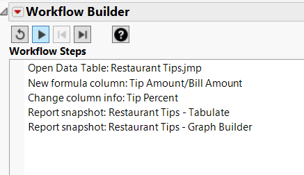

Stop Recording and Test the Workflow
1. Click Image shown here to stop recording.
2. (Optional) Click the Workflow Builder red triangle and select Display Options > Presentation Mode.
Figure 13.4 Workflow Builder in Presentation Mode
3. Click Image shown here to reset. This closes any open windows and resets the workflow to the start.
Note: The reset button closes only those windows opened by the workflow. The reset button does not close message windows.
4. Click Image shown here to test the workflow.
Tip: You can perform these steps to test your workflow at any time. You can continue to edit the workflow after testing.
