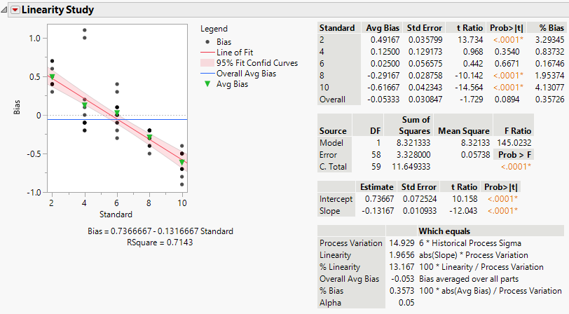

Linearity Study
Use the Linearity Study option to determine whether there is a significant relationship between the size of the parts and the operator’s ability to measure them. First, you must specify a historical process sigma.
1. Click the Variability Gauge Analysis for Response red triangle and select Gauge Studies > Edit MSA Metadata.
2. In the Edit MSA Metadata window, enter 2.488105 as the value for the Historical Process Sigma. This is the standard deviation of the response. The Historical Process Sigma is used to calculate the Process Variation.
3. Click OK.
4. Click the Variability Gauge Analysis for Response red triangle and select Gauge Studies > Linearity Study.
Figure 6.12 Linearity Study
Linearity Study
Note the following:
The slope is -0.131667. This value appears as part of the equation below the graph, and also in the third table.
The p-value associated with the test on the slope is quite small, <.0001. The t test for the slope is testing whether the bias changes with the standard value.
Because the p-value is small, you can conclude that there is a significant linear relationship between the size of the parts and the operator’s ability to measure them. You can also see this in the graph. If the part or standard value is small, the bias is high, and vice versa.
