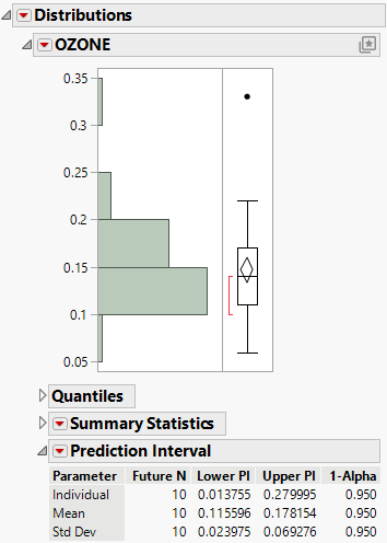

Figure 3.20 Example of a Prediction Interval Report
In this example, you can be 95% confident about the following:
Each of the next 10 observations will be between 0.013755 and 0.279995.
The mean of the next 10 observations will be between 0.115596 and 0.178154.
The standard deviation of the next 10 observations will be between 0.023975 and 0.069276.
