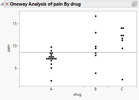

Use the Oneway platform to perform a one-way analysis of variance. This analysis enables you to test for statistically significant differences in group means. In this example, thirty-three participants were administered three different types of analgesics (A, B, and C). The participants were asked to rate their pain levels on a sliding scale. You want to find out if the mean pain levels for treatments A, B, and C are statistically significantly different.
1. Select Help > Sample Data Folder and open Analgesics.jmp.
3. Select pain and click Y, Response.
4. Select drug and click X, Factor.
5. Click OK.
Figure 6.2 Example of Oneway Analysis
You notice that one drug (A) has consistently lower pain scores than the other drugs. You also notice that the x-axis ticks are unequally spaced. The length between the ticks is proportional to the number of scores (observations) for each drug.
