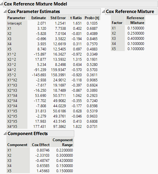

Figure 4.62 Cox Mixtures
Cox Mixtures
The report contains the parameter estimates for the Cox mixture model, along with standard errors and hypothesis tests. The reference mixture appears on the right. The component effects appear below, along with the component ranges.
