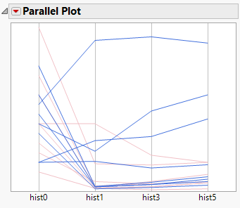

The report window appears.
Figure 7.2 Parallel Plot of Histamine Variables
Each connected line segment represents a single observation. Click a line segment to see which observation (or row) it corresponds to in the data table.

Only the trimeth values are highlighted in the parallel plot.
Figure 7.3 Trimeth Values Highlighted
You observe the following about the histamine levels for dogs given trimeth:
For most of the dogs, the histamine levels had a sharp drop at one minute.
For four of the dogs, the histamine levels remained high, or rose higher. You might investigate this finding further, to determine why the histamine levels were different for these dogs.
