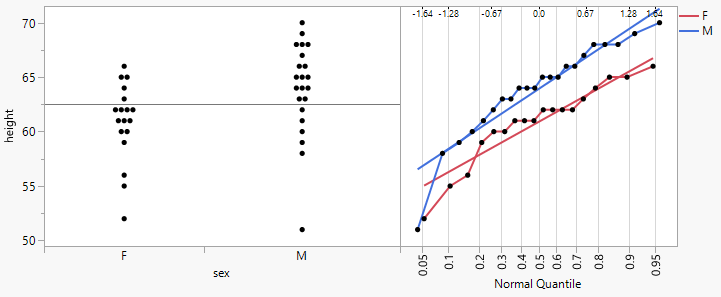

Use the Oneway platform to produce a normal quantile plot.
1. Select Help > Sample Data Folder and open Big Class.jmp.
3. Select height and click Y, Response.
4. Select sex and click X, Factor.
5. Click OK.
6. Click the Oneway Analysis red triangle menu and select Normal Quantile Plot > Plot Actual by Quantile.
Figure 6.31 Example of a Normal Quantile Plot
Note the following:
The Line of Fit appears by default.
The data points track very closely to the line of fit, indicating a normal distribution.
