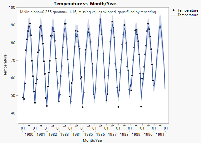

Figure 4.27 Forecast Plot of Maximum Monthly Temperature
The graph shows the data points used to estimate the time series function that extends through the forecast period. Note the following about this graph:
The solid blue line represents the forecast model. The shaded blue area is the 95% confidence interval around the predicted values.
The forecast period covers 1991, which is 12 months past the last data point. The forecast period is the right most portion of the plot that has no data points.
The peak forecast high for 1991 is in July with an estimated value of 90oF. This estimate has a confidence interval of about 83oF to 96oF represented by the limits of the blue region above and below the estimate.
The text at the top indicates the type of model that was fit, the parameter values for that model, and information about missing values. To remove this text from your graph, deselect the Forecast Model option in the Line of Fit properties panel.
