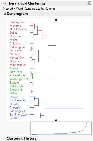

Figure 13.6 Dendrogram Report for Flight Distances
In the Dendrogram report for the flight distances, the placement of the diamonds indicates that the model has grouped the cities into three clusters. The clusters are color-coded on the dendrogram. For more information about how to interpret the report, see Dendrogram.
