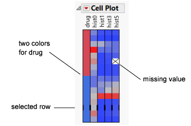

Figure 8.2 Dogs.jmp cell plot
Dogs.jmp cell plot
Notice the following:
There are two types of drugs, represented by two distinct colors.
Histamine levels are assigned colors from a gradient of blue to red.
Any missing values are delineated by an X.
The third row from the bottom is selected, and black lines appear next to the cells.
