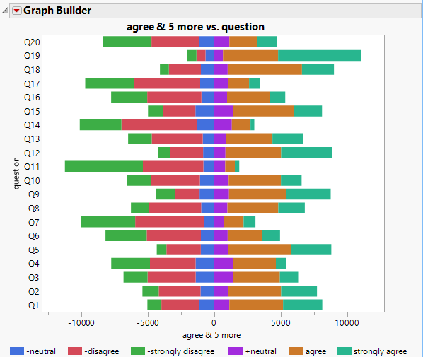

7. Click the Graph Builder red triangle and select Legend Position > Bottom.
8. Click Done.
Figure 4.15 Graph Prior to Legend Customizations

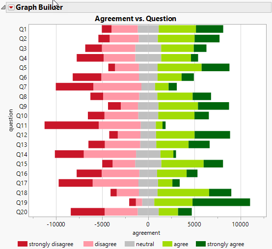

Customize the Legend Colors and Ordering
1. Right-click on each color in the legend and change the Fill Color:
Light gray for +neutral and -neutral
Light pink for -disagree
Red for -strongly disagree
Light green for agree
Dark green for strongly agree
2. Hover over any item in the legend. The cursor should appear as a hand. Double-click to open the Legend Settings window.
3. Highlight a variable and use the arrow icons to change the order from top to bottom: -strongly disagree, -disagree, -neutral, +neutral, agree, strongly agree.
4. Double-click +neutral and rename it to neutral.
5. Deselect the box next to -neutral so that it no longer appears in the legend, because it is a duplicate.
6. Double-click -strongly disagree and -disagree and remove the - sign.
Figure 4.16 Completed Legend Settings
7. Click OK.
8. Change the titles of the X axis and graph:
a. Click the graph title and enter Agreement vs. Question.
b. Click the X-axis title and enter agreement.
9. Double-click in the Y axis and select the Reverse Order box, and then click OK.
10. Double-click in the X axis and select the Major Grid Lines box, and then click OK.
The grid lines help you visually judge the differences between question results.
Figure 4.17 Final Likert Scale Graph
Tip: If an item in the legend is still highlighted, click it to deselect it.
This graph provides a visual summary of 20 survey questions, ignoring the non-responses. Note that the non-responses are less than 1% of the total responders for any question. Therefore, leaving them out of the visualization does not impact the conclusions. Question 19 has the most positive responses, and Question 11 has the least favorable responses.
