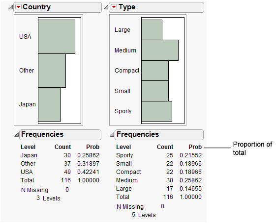

Figure 5.9 Distribution for Country and Type
Interpret the Distribution Results
The report window includes a bar chart and a Frequencies report for Country and Type. The bar chart is a graphical representation of the frequency information provided in the Frequencies report. The Frequencies report contains the following:
Categories of data. For example, Japan is a category of Country, and Sporty is a category of Type.
Total counts for each category. For example, there are 22 compact cars.
Proportion of the total each category represents. For example, the 22 compact cars make up about 19% of the 116 observations.

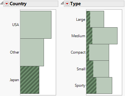

Selecting a bar in one chart also selects the corresponding data in the other chart. For example, select the Japan bar in the Country bar chart to see that a large number of Japanese cars are sporty.
Figure 5.10 Japanese Cars
Japanese Cars

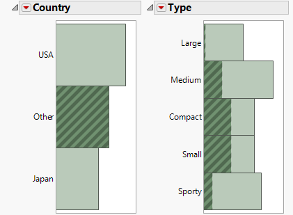

Select the Other category to see that a majority of these cars are small or compact, and almost none are large.
Figure 5.11 Other Cars
Other Cars
