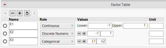

The factor values section of the Factor Table enables you to set the experimental settings, or levels, for the factors. The factor value settings differ for each factor type. For continuous factors, enter the lower and upper limits to define the factor range. For discrete numeric factors, enter a value for each discrete level. For categorical factors, enter a value for each level. For discrete numeric and categorical factors, use the plus and minus buttons to adjust the number of levels. To update values, click the default values and enter the desired values.
Figure 7.10 Factor Values
