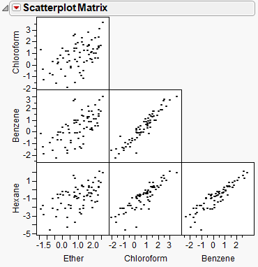

Figure 4.16 Scatterplot Matrix
Scatterplot Matrix
Interpret the Scatterplot Matrix
The scatterplot matrix provides these answers:
All six pairs of variables are positively correlated.
As one variable increases, the other variable increases too.
The strongest relationship appears to be between Benzene and Chloroform.
The data points in the scatterplot for Benzene and Chloroform are the most tightly clustered along an imaginary line.
