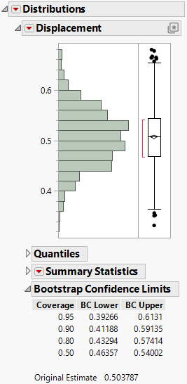

Figure 11.1 Bootstrapping Results for a Slope Parameter
