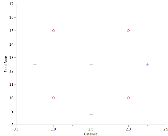

Figure 6.1 Original Design Runs (+) with Augmented Runs (o)
