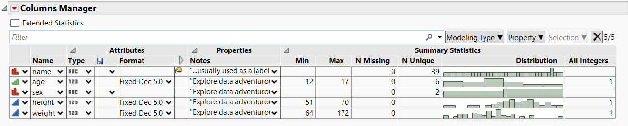

Figure 5.5 The Columns Manager Window
The Columns Manager window contains the following information:
Modeling Type
Displays the modeling type of each column which tells JMP how to treat the column’s values during analyses. You can change the modeling type to look at a variable in different ways. See About Modeling Types.

Name
Displays each column’s name.
Attributes
The Attributes grouping displays the modeling type, subtype, format, and row state attributes.
Type
Displays the modeling type of each column. See About Modeling Types.

Format
(Numeric columns only) Displays the numeric format of the column. See Numeric Formats.
Flags
Displays the row state flag of each column. See Store Information in Row State Columns.
Expand the grouping to organize columns by the available row state options. Row state categories available to view and sort by include:

Properties
Displays the properties assigned to each column. This field is hidden by default if no properties have been assigned. See Column Properties in JMP.
Summary Statistics
Displays the basic summary statistics including Min, Max, N Missing, N Unique, Distribution, and All Integers. Select Extended Statistics in the Columns Manager window to add Mean, Std Dev, Q1, and Q3. See Explanation of Summary Statistics.
