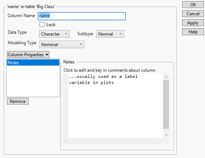

Figure 5.2 The Column Info Window for a Character Column
The Column Info window contains the following information:
Column Name
Type or edit the name of the column.
Lock
Lock the column so that none of its values can be edited. After you lock a column, the lock icon (Image shown here) appears next to the column name in the data table’s Columns panel. If you add a formula to a column, the column automatically locks.
