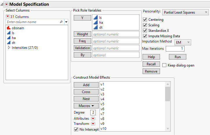

Figure 6.6 JMP Pro Partial Least Squares Launch Window (Imputation Method EM Selected)

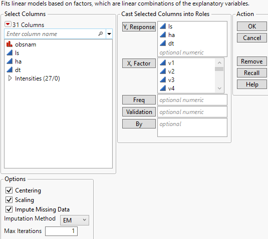

Figure 6.7 JMP Pro Fit Model Partial Least Squares Launch Window
