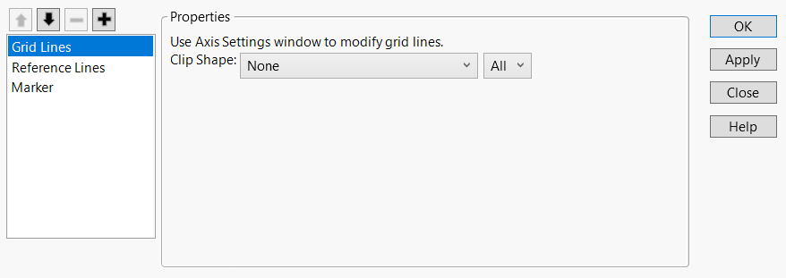

4. Right-click inside the graph and select Customize.
Figure 12.1 Customizing the Graph Options
5. Click the Add button Image shown here to add a new graphics script.

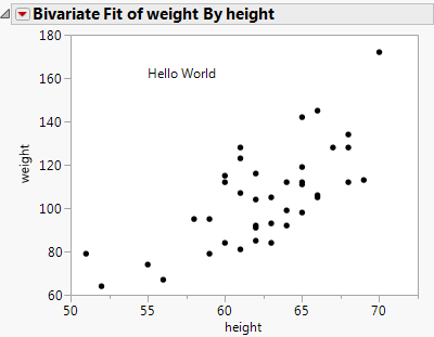

Text( {55, 160}, "Hello World" );
Now the graph has a text element at the graph’s x-coordinate 55 and y-coordinate 160.
