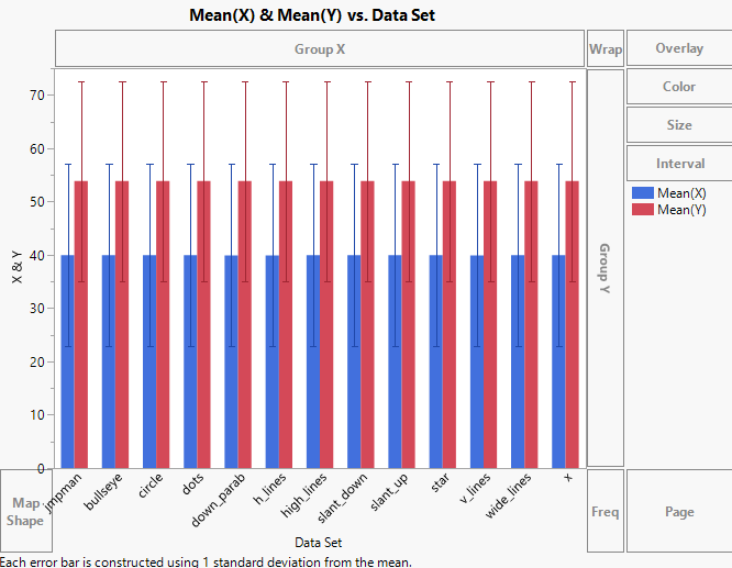

1. Select Help > Sample Data Folder and open JMP Man Dozen.jmp.
3. Select X and Y and drag them to the Y zone.
4. Select Data Set and drag it to the X zone.
5. Click the Bar element Image shown here.
6. For the Error Interval, select Standard Deviation.
Figure 9.43 Original Graph for JMP Man Dozen.jmp
You can see that the mean and standard deviation for these observations are the same, so this graph does not tell you much. Use preset graphs to get more insight into the data.

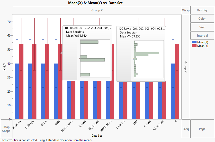

1. In the graph, right-click and select Hover Label > Histogram.
This adds preset histograms to the hover labels.
2. Point to some of the bars. In this example, point to the red bars for dots and star.
Tip: To make the hover label remain so that you can compare it with other hover labels, click the Pin icon Image shown here in the top right corner. See Pin Hover Labels in JMP Graphs.
Figure 9.44 Example of Preset Histograms
You can see that the distribution for the measurements is clearly different. But you want to see another type of graph, a scatterplot.

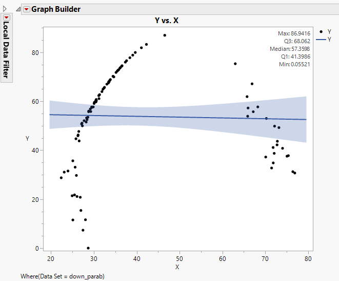

1. Hover over the blue bar for down_parab and click the graph to open it in a new window.
The graph opens in Graph Builder.
Note: Notice that when you launch a preset graph, you see a Local Data Filter at left. You can use the Local Data Filter to expand and change the graph. For details, see Local Data Filters in JMP Reports.
2. Click the Graph Builder red triangle and select Show Control Panel.
3. Click the Line of Fit element Image shown here.
4. Click the Caption Box icon Image shown here.
5. Under Caption Box, change the Summary Statistic to 5 Number Summary.
6. Click Done.
Figure 9.45 Customized Graph for down_parab

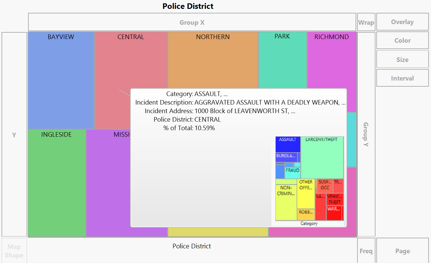

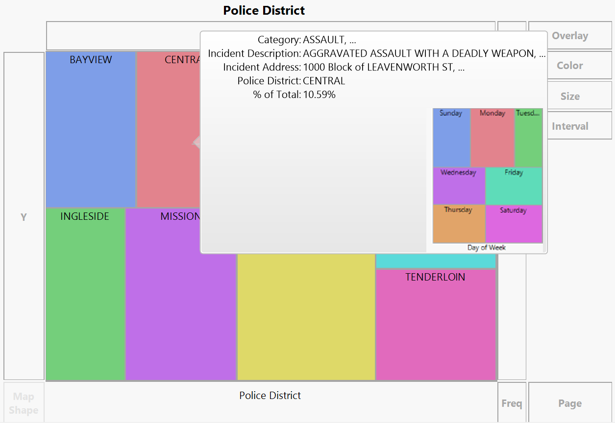

5. Right-click on the graph and select Hover Label > Treemap.
6. Put your cursor over Central to see the hover label graph.
Figure 9.46 Initial Hover Label Graph for Central
The hover label graph is showing the number of incidents in each district by the day of the week. Instead, in this example, you want to see the number of incidents in each district by category.

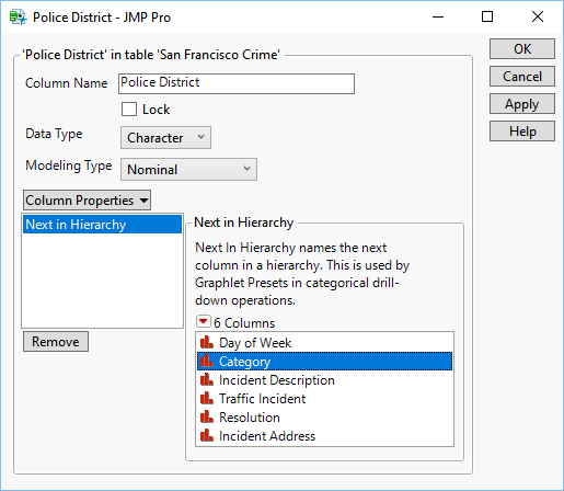

1. In the San Francisco Crime.jmp data table, right-click the Police District column heading and select Column Properties > Next in Hierarchy.
2. Under Next in Hierarchy, click Category.
Figure 9.47 Category Selected for Next in Hierarchy
3. Click OK.

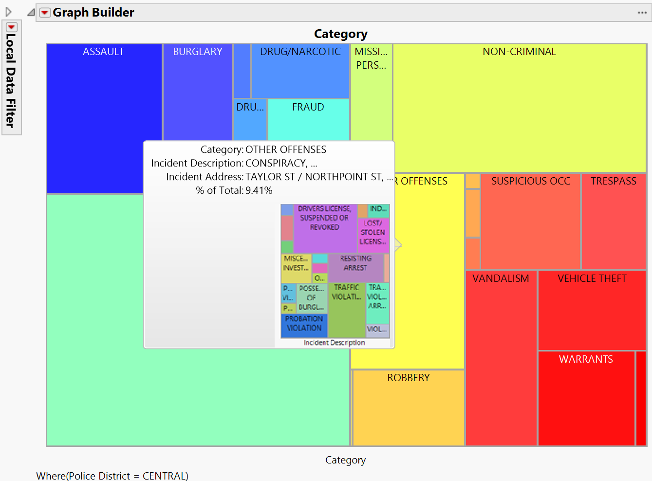

6. Click the hover label graph to launch it.
7. Put your cursor over Other Offenses.
Figure 9.49 Second Level Hover Label Graph for Other Offenses Category
The second level of the hover label graph is showing the number of incidents in the Other Offenses category by the incident description.

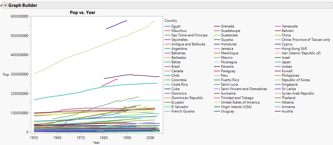

This graph shows the mean population in each world region over different years. In the hover label graphs, you want to see a more granular view that shows the impacts by country instead of region.
7. Keep this window open.

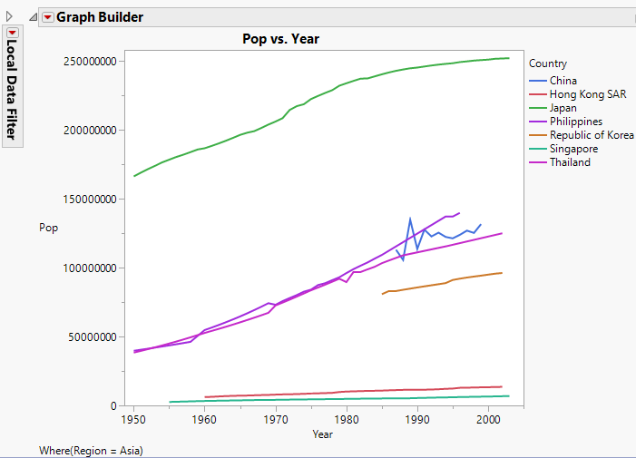

6. In the original graph, right-click and select Hover Label > Paste Graphlet.
7. Hover over the Asia line and click to launch the hover label graph.
Figure 9.52 Hover Label Graph Showing Population by Country and Year for the Asia Region
Hover Label Graph Showing Age Rates by Country and Year for the Asia Region

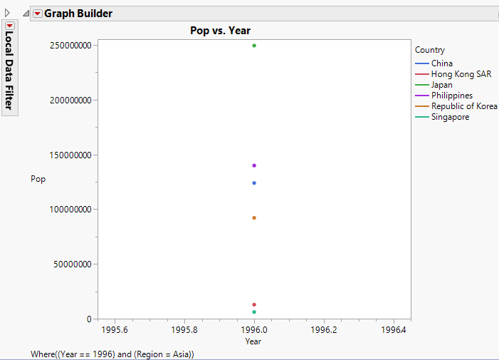

Because we are still filtering by year, this view is too granular to be useful. You want to remove the year filter, so the graph filters only by region.
8. Close the hover label graph for the Asia region.

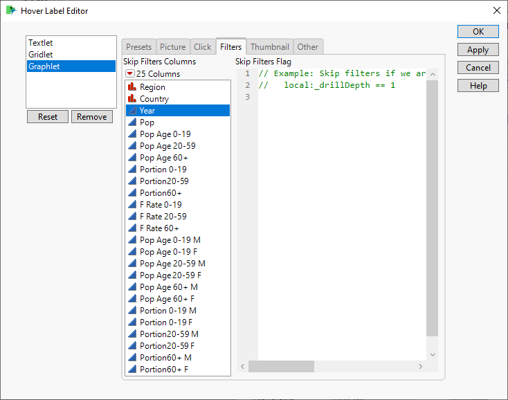

Remove a Filter Column
1. Right-click the original graph and select Hover Label > Hover Label Editor.
2. In the Graphlet window, click the Filters tab.
3. Select Year, the column you no longer want to filter by.
Figure 9.53 Skip Filters in the Hover Label Editor
4. Click OK.

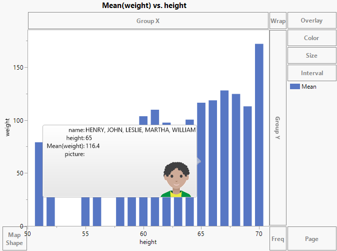

For labeled columns, hover labels can contain an image from the first labeled image column and up to four values from labeled text columns. To show more labeled images or text observations, use the Label Viewer.
1. Select Help > Sample Data Folder and open Big Class Families.jmp.
3. Select weight and drag it to the Y zone.
4. Select height and drag it to the X zone.
6. Hover over the bar for the height of 65 inches and click Pin Image shown here.
Figure 9.55 Hover Label with Only Initial Image
Although five names are included in this bar, only the first image (Henry) appears in the hover label. You want to see more images in the hover label.
7. Right-click in the graph and select Hover Label > Label Viewer.
Figure 9.56 Hover Label with Multiple Images
The maximum of eight images now appear in the hover label.
8. To see the additional image, in the hover label, click a thumbnail.
9. In the Label Viewer, click the Forward arrow Image shown here to see the fifth image.
