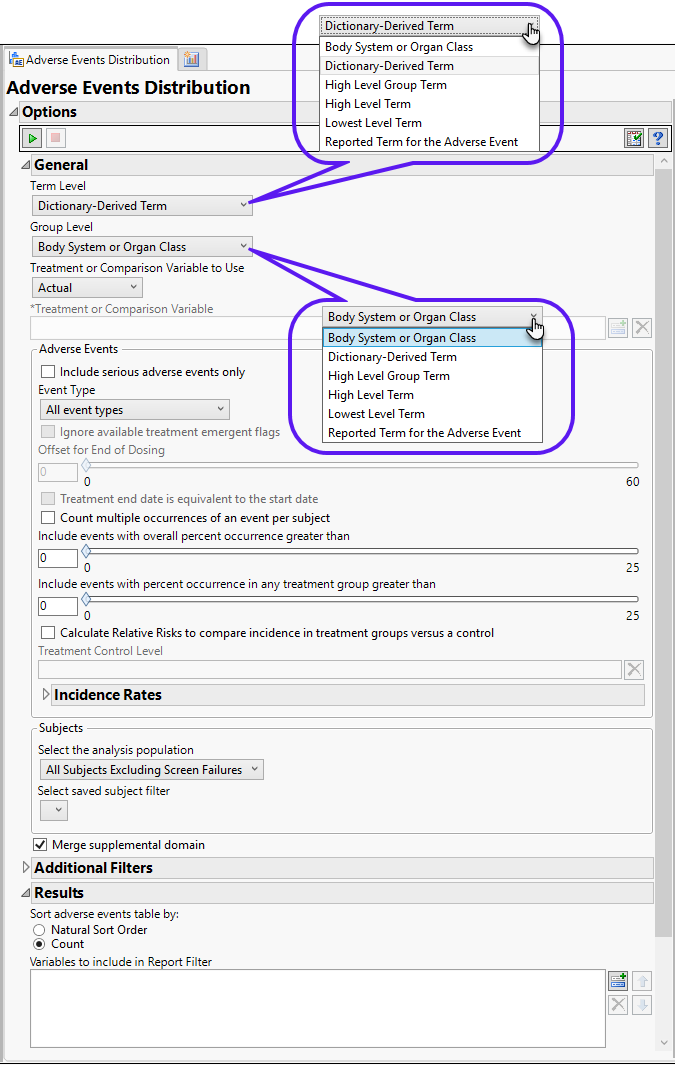

The Adverse Events Distribution dialog (shown below) enables you to use the term level and group level that are available in your ae.sas7bdat data so that while AEDECOD and AEBODSYS are specified by default variables in the examples shown here, this specification can be customized based on the term levels available in the given Study.

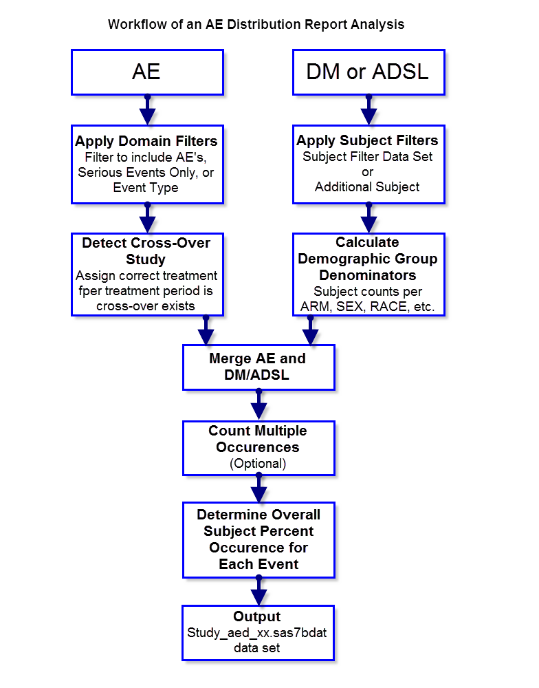

The following diagram outlines the analysis performed to summarize adverse events count and percent calculations for the Adverse Events Distribution report.
Distribution Workflow Steps
Apply Domain Filters
Three parameters, Include serious adverse events only, Event Type and Offset for End of Dosing, are used to specify a domain filter.
Available options are described in the following table:
Option:
Select when you want to:
• Include only those event records with AESER = Y
Event Type options rely on the available Date/Time start and end variables referenced above. Options include:
All event types
• Include all events.
Pre treatment events
• Include events that occur before dosing for treated subjects.
• AESDTC before RFXSTDC, for example.
Treatment emergent adverse events
• Include events that occur on or after the first dose of study drug, or are flagged as treatment emergent based on AETRTEM or TRTEMFL.
On treatment events
• Include events that occur on or after the first dose of study drug and at or before the last dose of drug (+ the offset for end of dosing).
• Include only events where AESDTC on or after treatment start date AND before treatment stop date.
• Use the optional Offset for End of Dosing for specifying end of dosing (to account for drug half-life, for example).
Off treatment followup events
• Include events that occur after the last dose of drug (+ the offset).
You can also use the Include the following adverse events: and Filter to Include Adverse Events options based on user-customized condition and/or on new/modified/stable records (when JMP Clinical snapshot comparison is being used)
Apply Subject Filters
These options filter the available subjects to use for the analysis and impact both the counts of adverse events (relevant events are considered only for subject in the analysis population) as well as for computing denominators to perform subject percent calculation.
Three parameters, Select saved subject filter, Additional Filter to Include Subjects and Select the population to include in the analysis, are used to specify a domain filter.
Option:
Select when you want to use a:
• Data set containing USUBJID values of subject to include in analysis. These data sets can be created from most of the JMP Clinical reports.
• General user-customized condition (enter Sex = "F" to include only females in the analysis, for example).
• A percent calculation is then only generated based on demographic variable groups for subjects meeting the filtering criteria.
• Filter the subject population based on available flags in the ADSL, ADDM, or DM (and optionally, SUPPDM) data tables.
Detect Crossover Study
If an ADSL table is defined and contains multiple treatment periods (TRTxxP for example) and treatment period start/stop dates, ADSL is merged in and the corresponding treatment and period is assigned based on comparison with AESDTC.
Calculate Demographic Group Denominators
Fixed adverse event frequency/percent values are not computed from output in the results data set. Instead, the subject counts for all relevant treatment and demography variables are computed, in order to support interactive computation of AE subject percent calculations based on user filtering and selection of treatment or demographic group categories.
Note: If you want to output static AE percent tables only, the Create Static Report() action button should be used.

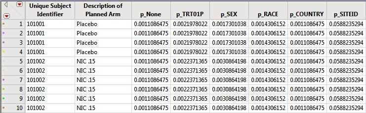

The subject counts for each value of relevant demographic variables (Treatment, SEX, RACE, COUNTRY, SITEID, STUDYID (if not constant) are computed and then the reciprocal of the subject count is recorded in the DM or ADSL data set for merging into AE. This value can be used as a frequency weight for each subject that has a specific event to calculate the percent of subjects for that given demographic group that experience the AE.
The following example uses the Nicardipine data included with JMP Clinical.
In this example:
• 455 subjects were on Placebo.
• The reciprocal 1/455 = .00219. This value can be used for each subject that has an AE to compute the percentage.
• 314 subject on placebo experience Vasoconstriction.
• 314 x 1/455 = 314/455 = .6901 or 69.0% of subjects on placebo experienced Vasoconstriction.
These reciprocal or frequency variables based on the demographic variable counts for each subject are computed and used when merged into the AE records table to compute percentages.
These columns are used in the distribution results dashboard to dynamically calculate percentages. Further examples are given when describing the dashboard results.
Note: If crossover is detected, these demographic counts represent the total subjects for treatment values summed across each period.
Merge AE and DM/ADSL
The (filtered) AE data and the (filtered) DM or ADSL table (with computed demographic frequencies) are merged by USUBJID (and treatment period if crossover is detected)
Optional Count Multiple Event Occurrence
The dialog contains an option to count multiple occurrences of events.
This option is turned OFF by default.
Percent calculations are performed only if this option is UNCHECKED so that when a unique event is counted only once per subject, you can interpret the frequency of AE counts as the percentage of subjects experiencing the event. The representative adverse event is chosen based on Seriousness (AESER if exists), Severity (AESEV), and computed study day (AESTDY or based on AESDTC)
Note: JMP Clinical assumes accordance with controlled terminology: "Y" to represent severe events, and "MILD", "MODERATE", "SEVERE" to select the serious, most severe event as representative.
For other events/interventions, the representative unique occurrence is chosen based on the first occurrence. The following help documentation for the Count multiple occurrences of an event per subject check box option describes the result of this option.
Box state:
Result:
Unchecked
Compute counts based on the number of subjects that had a specific intervention.
Each subject contributes only one time to the occurrence count of an intervention, regardless of how many times that specific intervention might have been applied to the subject.
Note: Representative intervention occurrence per subject is selected by sorting the data and taking the first intervention occurring to a subject based on Study Day.
Checked
Compute counts based on the overall counts of interventions, including multiple occurrences per subject.
Overall Subject Percent Occurrence for Each Event
This step is performed only when a unique occurrence of an event is counted (based on above check box option). This is total percent of subjects experiencing an event, calculated for each event.
For example, in the Nicardipine data , 560 of the 902 subjects in the safety population experienced vasoconstriction.
• 560/902 = 0.621 or 62.1% of all subjects had a vasoconstriction event, regardless of treatment.
After all of these steps have been completed, the STUDY_ae_xx.sas7bdat results table is used for the JMP results dashboard report.

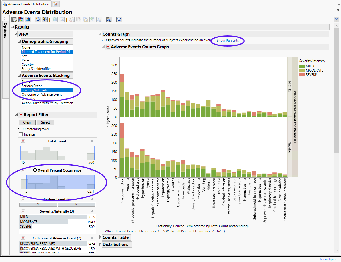

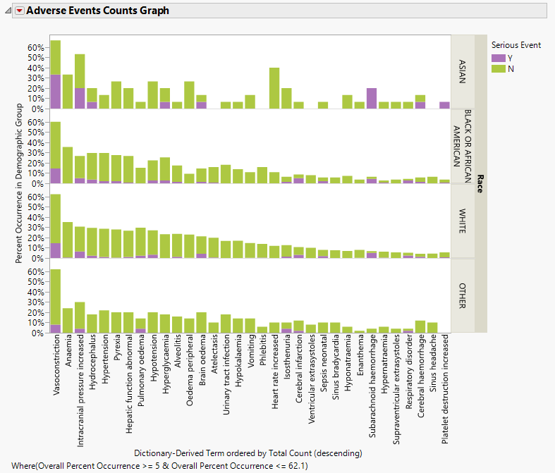

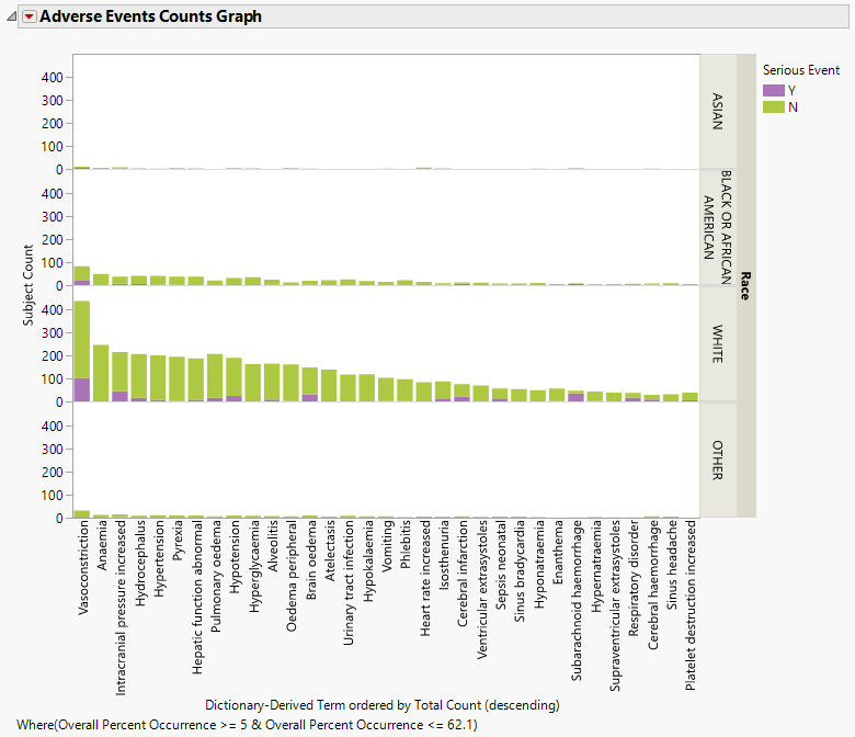

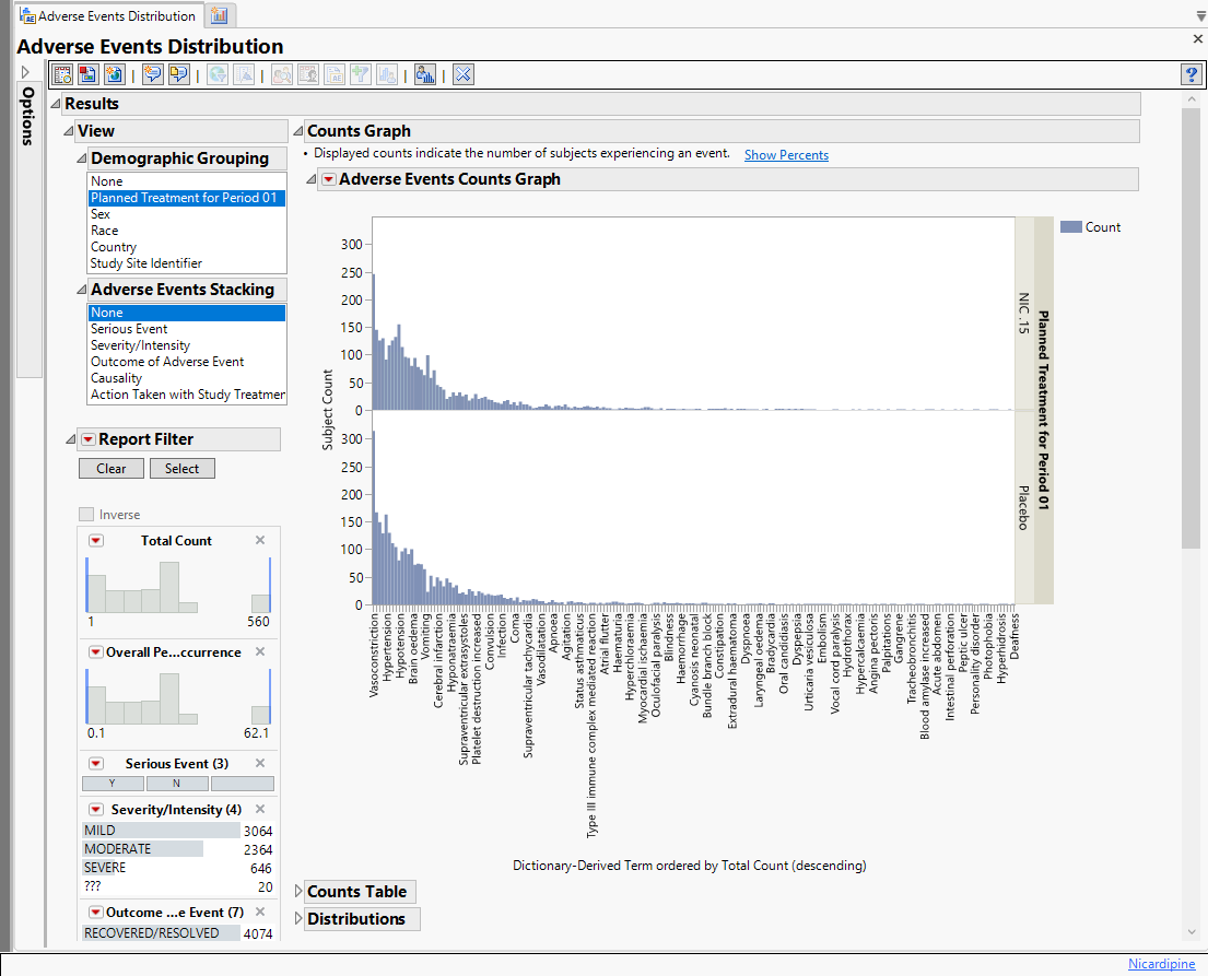

The AE Distribution report described in this example is shown below:

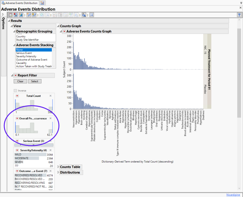

Example 1: AE Distribution Treatment Emergent Adverse Events That Occur in at Least 5% of Subjects in a Safety Population
8 Open Adverse Events Distribution.

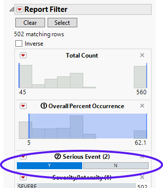

8 Find the filter option that enables you to set the overall percent occurrence (circled below):
8 Use your cursor to "grab" the lower limit and drag it to 5%.
8 Adjust the Adverse Event Stacking optionto display results by Severity/Intensity.
The results of this analysis are based on summarizing adverse events by Dictionary-Derived Term (AEDECOD) with group organization as Body System or Organ Class (AEBODSYS). Variations of options for this are dependent on the available terms in the domain data set.
The counts (Y axis) represent the count of subjects that experienced the given event term (X axis); the counts are categorized as stacked bar charts for levels of Severity/Intensity (AESEV). This categorization is a result of choosing that variable from the AE Stacking action button.
When a unique occurrence is counted only for each subject/event, the percent of subjects experiencing an event within any of the available demographic grouping variables is calculated interactively by the report. The plot below was generated by clicking Show Percents (circled above).

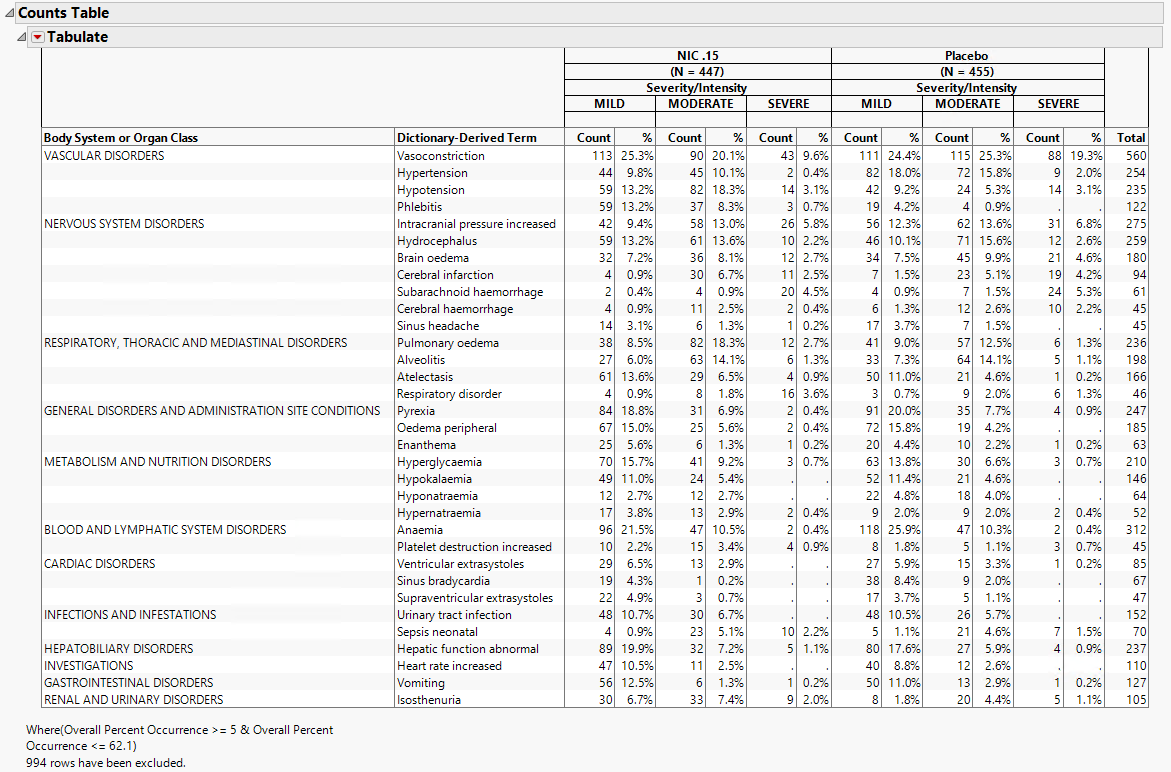

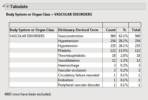

The counts table (shown below) reflects the same counts/percentages as shown in the counts plot in tabular form. The Grouping and Stacking column from the down panel drive the format and detail in this table. This flexibility enables you to create several tables for summarizing events from one report.

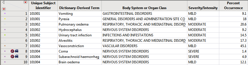

The output STUDY_aed_xx.sas7bdat data set used to generate these plots and tables contains a row for each subject experiencing each event (optionally by treatment period in a crossover scenario).
Rows that do not meet the Percent Occurrence Threshold specified on the dialog (5% in this example) are hidden and excluded from analysis. This filter can be interactively changed using the Report Filter option for Percent Occurrence (circled above).

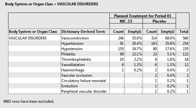

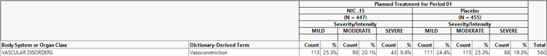

Example 2: Using the action button on the Output dashboard, select Planned Treatment for Period 1 for Demographic Grouping and None for AE Stacking and examine the Counts Table tab. Note how the values change.
246/447 = .550 55.0% of subjects on NIC .15 experienced vasoconstriction
314/455 = .690 69.0% of subjects on Placebo experienced vasoconstriction

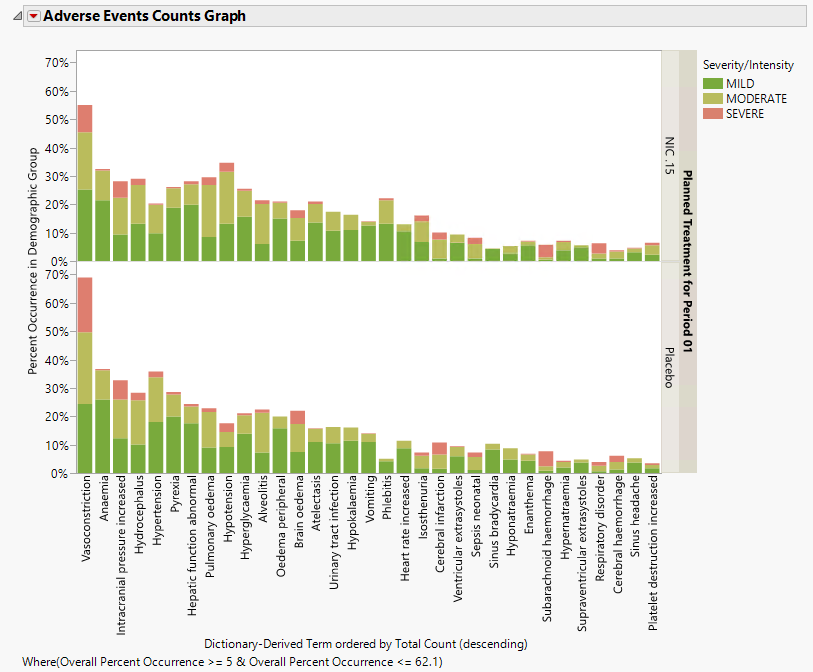

Example 3: Using the action button on the Output dashboard, select Planned Treatment for Period 1 for Demographic Grouping and Severity/Intensity for AE Stacking and examine the Counts Table tab. Note how the values change.
113/447 = 25.3% of subjects on NIC .15 experienced MILD vasoconstriction
90/447 = 20.1% of subjects on NIC .15 experienced MODERATE vasoconstriction
43/447 = 9.6% of subjects on NIC .15 experienced SEVERE vasoconstriction
111/455= 24.4% of subjects on Placebo experienced MILD vasoconstriction
115/455= 25.3% of subjects on Placebo experienced MODERATE vasoconstriction
88/455= 19.3% of subjects on Placebo experienced SEVERE vasoconstriction
Note: In the example, the demographic group column changes the percent calculations (also known as changes the value of the denominator used in the formula), while the stacking/categorization variable just partitions the counts and percentages.
The value of percent calculation comparison can be seen clearly in the two plots shown below. The first plot shows the AE Counts graph grouped by RACE and categorized by Serious Event.
This plot can be misleading because of the large differences in the respective number of subjects in each RACE category. In this case, comparing the percentages might be more informative.
8 Click Show Percents (located above the plot and circled below).
The resulting plot (below) then is much more useful for making comparisons.
Percent Calculations When an Interactive Data Filter Is Applied.
When you use the Data Filter (located on the right side of the report) to filter the records that are shown, the change does NOT affect the demographic group denominator values that are used in the percent calculations. These denominators, as described previously, are derived in the SAS programming of the analysis based on the analysis population. The counts (the numerator in the percent formula) of subjects experiencing the event (and now meeting the data filter criteria) change values to reflect the use of the data filter.
In the following example, the default (Event Type = All) Adverse Events Distribution report was run for the Nicardipine sample data and the results were subsequently filtered for Serious Event = Y, as shown below:
The results are shown below:
88/455 = 19.3% of subjects on Placebo experienced serious vasoconstriction.

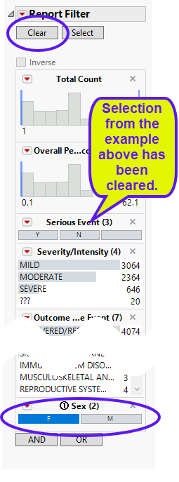

If the Data Filter selection is based on a demographic variable, care must be taken to interpret the results.
In the following example, Sex = F has been selected in the data filter:
Note: You must click (circled above) to clear out prior filters before making a new selection.
206/455 = 45.3% of subjects on Placebo were females with vasoconstriction.

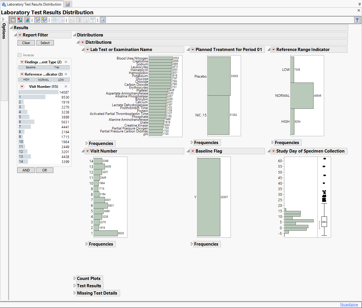

For the Findings Distribution report, these distributions are the initial view. The findings calculations follow the same workflow as described by the events computation, but are simpler because no percent calculations are performed. Most of the analyses are derived using the JMP reports.
Findings Distributions Results
The Findings Distribution report might contain the following results:
• Distributions: Contains distributions of parameters from the specified Findings domain.
• Count Plots: Contains graphs for each test to display measurement counts within categories of the Reference Range Indicator variable. This tab is displayed only if the xxNRIND variable is present in the Findings domain data (typically the LB domain).
• Test Results: Contains One-way Analyses (ANOVA) for each test that has numeric measurement results (xxSTRESN values), Contingency Analyses for each Findings test that has character results (xxSTRESC values but missing xxSTRESN values), or both.
• Missing Test Details: Contains tables displaying subject counts for tests that were either not recorded, or that were recorded but have missing measurement values (of xxSTRESN and/or xxSTRESC). If all subjects had nonmissing recorded test measurements for all tests, this tab is not shown.
The Distribution tab is shown above. The other three tabs are shown below:

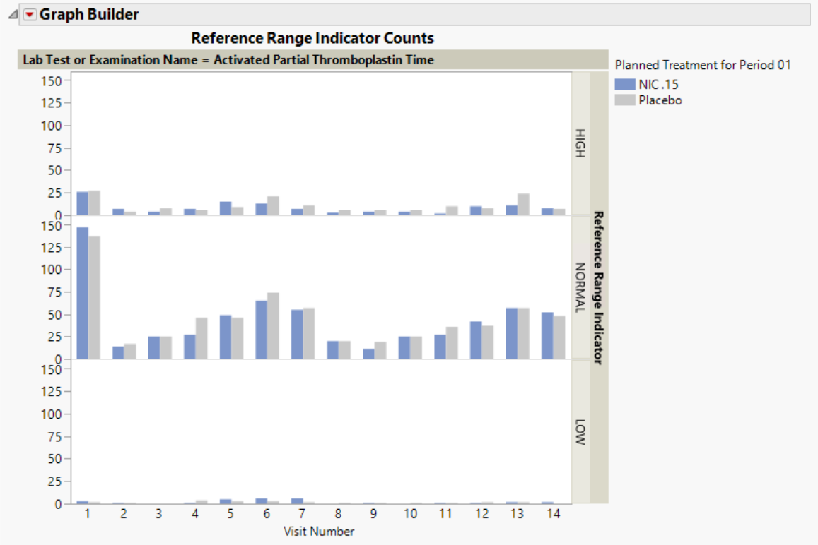

Count Plots: This plot shows counts of records from the Findings domain by Study Visits. The xxNRIND and either the VISIT or VISITNUM variables are required in the domain in order to produce these plots.
