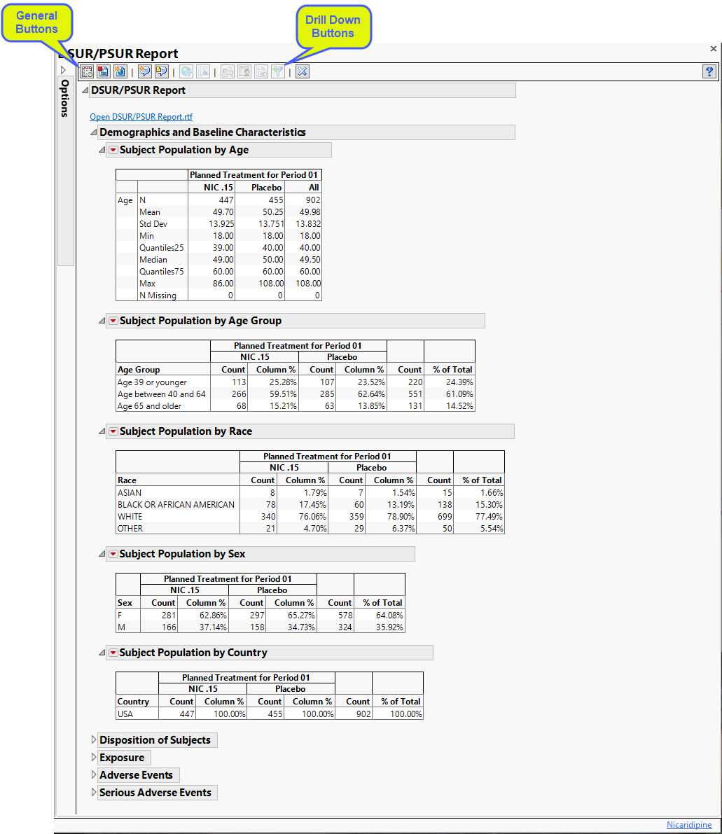

The Report contains the following elements:
Demographics and Baseline Characteristics
The tables in this section (shown below) summarize demographic information about the subjects in this study. Both count and percentile data are provided by treatment arm.

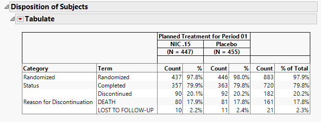

Disposition of Subjects
The table in this section (shown below) summarizes disposition information about the subjects in this study. Both count and percentile data are provided for each disposition event broken out by treatment arm.
The order of variables selected to use for Randomization of the disposition table order is as follows: first RANDFL, then RAND, then RANDOMIZED, then either RANDOM, or RANDDT in ADSL or DM. If none of those variables exist, look in DS for records where DSDECOD=RANDOMIZED.

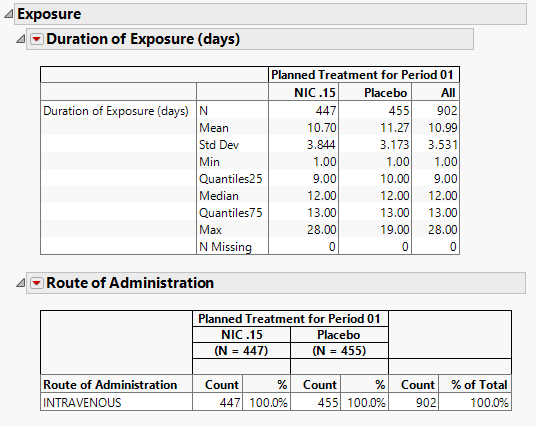

Exposure
The tables in this section (shown below) summarize length of exposure by treatment arm. Treatment administration methods are also summarized.

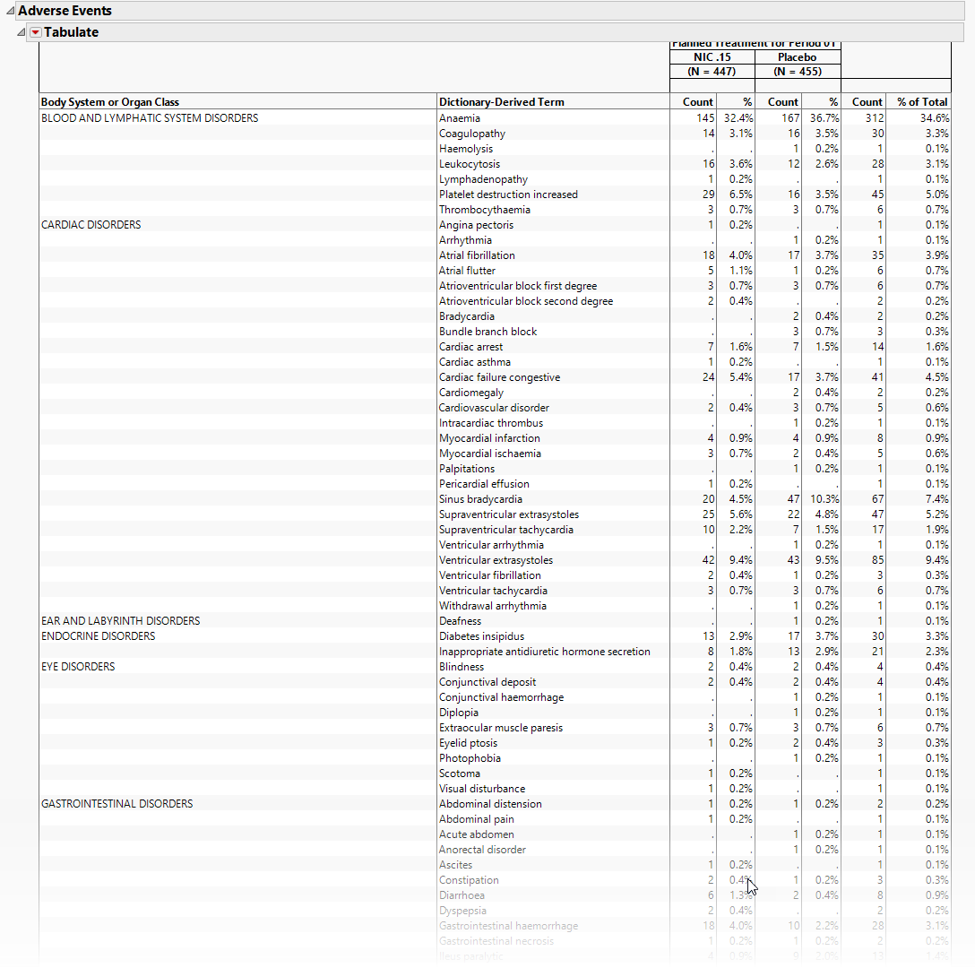

Adverse Events
The tables in this section (shown below) summarize adverse events experience by subjects in this study. Both count and percentile data are provided by treatment arm.

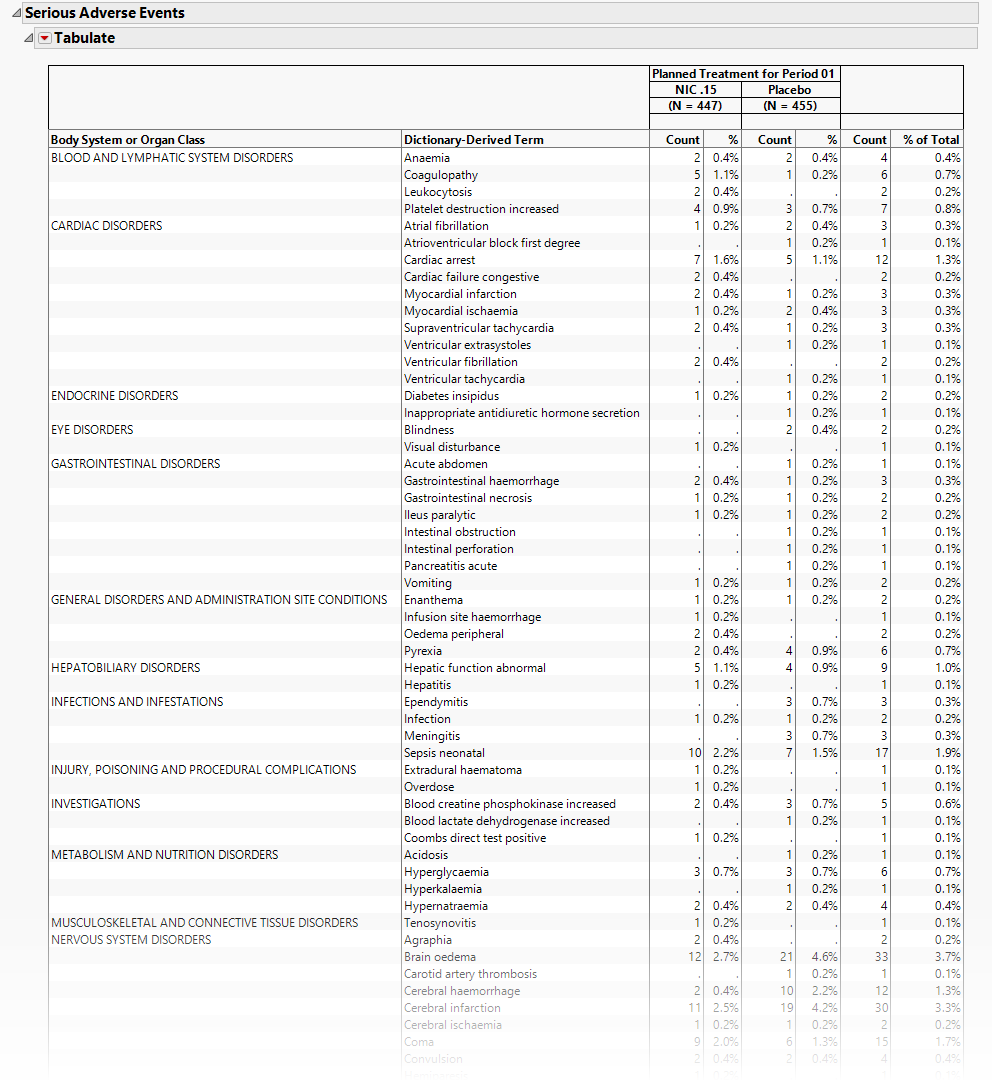

Serious Adverse Events
The tables in this section (shown below) summarize serious adverse events experience by subjects in this study. Both count and percentile data are provided by treatment arm.
Action Buttons
Action buttons, provide you with an easy way to drill down into your data. The following action buttons are generated by this report:
• Profile Subjects: Select subjects and click to generate the patient profiles for subjects experiencing selected events. See Profile Subjects for additional information.
• Show Subjects: Select subjects and click to open the ADSL (or DM if ADSL is unavailable) of selected subjects for subjects experiencing selected events.
• Adverse Events Narrative Generation: Select subjects and click to open the Adverse Events Narrative dialog. From this dialog, you can customize options and generate a narrative.
• Create Subject Filter: Select subjects and click to create a data set of USUBJIDs for subjects experiencing selected events, which subsets all subsequently run reports to those selected subjects. The currently available filter data set can be applied by selecting Apply Subject Filter in any report dialog.

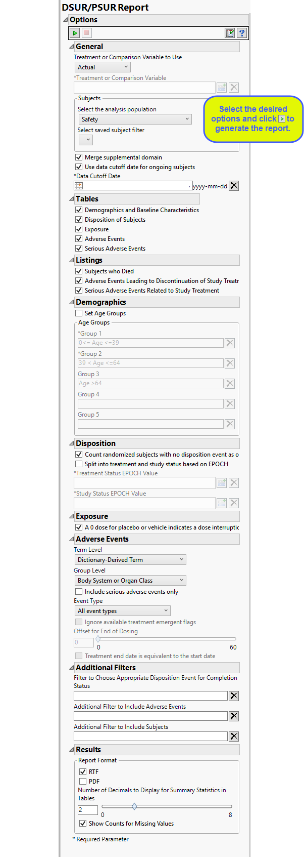

Report Options
General:
The primary goal of clinical trials is to distinguish treatment effects when reporting and analyzing trial results. Treatments are defined by specific values in the treatment or comparison variables of the CDISC models. These variables are specified in this report using the Treatment or Comparison Variable to Use andTreatment or Comparison Variable options.
Distributions of the specified treatment or comparison variables are shown in the output.
Available variables include Planned, which is selected when the treatments patients received exactly match what was planned and Actual, which is selected when treatment deviates from what was planned.
You can also specify a variable other than the ARM or TRTxxP (planned treatment) or ACTARM or TRTxxA (actual treatment) from the CDISC models as a surrogate variable to serve as a comparator. Finally, you can select None to plot the data without segregating it by a treatment variable.
Filters enable you to restrict the analysis to a specific subset of subjects, based on values within variables. You can also filter based on population flags (Safety is selected by default) within the study data. See Select the analysis population, and Select saved subject filter, for more information.
If there is a supplemental domain (SUPPAE) associated with your study, you can opt to merge the non-standard data contained therein into your data. See Merge supplemental domain for more information.
For subjects who are ongoing in the study, it is useful for indicating the date on which the data for this update report was pulled, particularly when considering exposure data. The Use data cutoff date for ongoing subjects and Data Cutoff Date options enable you to specify and use a data cutoff date for reporting on ongoing subjects.
Tables and Listings
You can specify whether to include tables summarizing data regarding Demographics and Baseline Characteristics, Disposition of Subjects, Exposure, Adverse Events, and Serious Adverse Events in your report. Selected tables are included in both the report output as well as any RTF/PDF output generated by this report.
Listings are subject level tables that list Subjects who Died, subjects who were discontinued along with the Adverse Events Leading to Discontinuation of Study Treatment, and any Serious Adverse Events Related to Study Treatment.
