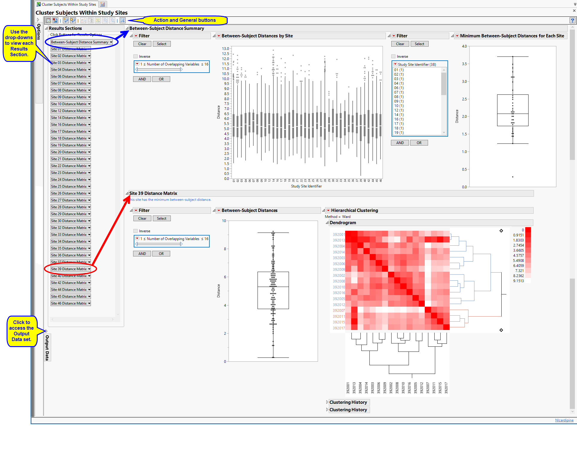

Report Results Description
Running this report for Nicardipine using default settings generates the report shown below.
The Cluster Subjects Within Study Sites report shows the results of clustering of the subjects on the basis of different combinations of covariates. The results for each grouping are presented in a separate “section”.
Results Section
This pane enables you to access and view the output plots and associated data sets on each section. Use the drop-down menu to view the section in the Results pane or remove the section and its contents from the Results pane.
Note: You might need to expand this pane to surface a scroll bar if the number of sections exceeds the spaces allotted.

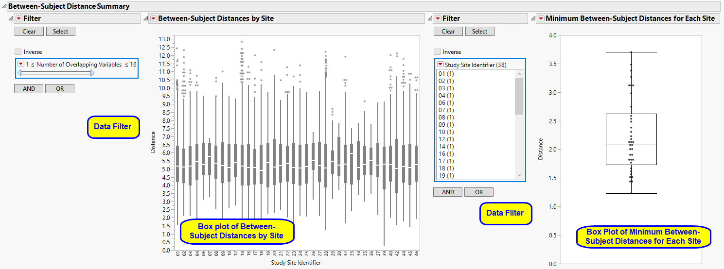

Between-Subject Distance Summary
This section presents box plots of the pairwise Euclidian Distances between subjects presented by site. The Euclidian Distance is calculated within study site. A Box Plot of the minimum pairwise distance taken from each site presented is shown below.
It contains the following elements:
• Two local Data Filters.
These enable you to subset subjects by study site and the number of overlapping variables. Refer to Data Filter for more information.
The data filters for this report include an option to specify the Number of Overlapping Variables. One of the challenges in this report is that distances may be very small, even zero. This may be driven by the fact that a patient may have a number of missing values for variables, and these don't contribute to the distance calculation. By default, SAS calculates the distance between pairs of variables that are non-missing for each pair of subjects. Number of Overlapping Variables makes it easier to subset to pairs that have a high-number of non-missing overlapping pairs of variables.
• One set of Box Plots of Between-Subject Distances by Site.
This figure shows box plotsof all pairwise Euclidian distances within each study site. Values closer to zero (0) reflect subjects that are very similar to one another, which could indicate that they are slightly modified copies.
• One Box Plot of Minimum Between-Subject Distances for Each Site.
The box plot of minimum pairwise distances provides some idea of the most similar subjects within each site.

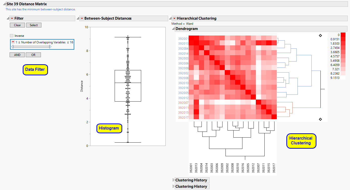

Site XX Distance Matrix
The Site XX Distance Matrix section is shown below. There is one section for each study site in the trial. However, only the site with the minimum pairwise distance is initially opened to minimize effects on performance. A box plot of all pairwise distances is presented as well as a Heat Map and Hierarchical Clustering display (using the Average method) to determine whether there are sets of subjects that are very similar.
• One Data Filter
This enables you to subset subjects based on the number of overlapping variables. Refer to Data Filter for more information.
• One Box Pot
Summarizes the distribution of all pairwise Euclidian distances within site XX. Small pairwise distances can be selected in the Box Plot and highlighted in the Hierarchical Clustering Heat Map with the button.
• One Hierarchical Clustering display.
Clusters subjects based on the pairwise Euclidian distances summarized in the box plot. Bluer color indicates subjects that are more similar, whereas red shows subjects less similar. The clustering dendrogram is presented to the right of the heat map and can show sets of more than two subjects that are similar to one another.
Action Buttons
Action buttons, provide you with an easy way to drill down into your data. The following action buttons are generated by this report:
• Profile Subjects: Select subjects and click to generate the patient profiles. See Profile Subjects for additional information.
• Show Subjects: Select subjects and click to open the ADSL (or DM if ADSL is unavailable) of selected subjects.
• Show Rows in Heat Map: Select points that represent pairs of subjects in the Box Plots and click to highlight the subjects within the Heat Map and Dendrogram to see how they cluster together.
• Subset Clustering: On a subgroup clustering page, subsets clustering to subjects, based on pairs selected from corresponding box plot.
• Revert Clustering: Click to return a subset clustering to the original state where all subjects are clustered.

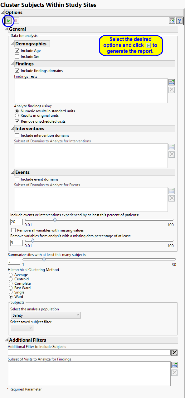

Report Options
Data and Analysis
Demographics
By default, the analysis Include Age. You can opt to Include Sex, as well, or to ignore either these if you choose.
Findings
You can opt to Include findings domains data. While all tests from all findings domains are included in the analysis by default, you can restrict the analysis to specified Findings Tests only. You can also select analysis units along with cutoff values for including events or interventions, for summarizing subgroups, and specify whether variables with missing values are allowed. You can Analyze findings using: either standard units or the original units.
Unscheduled visits can occur for a variety of reasons and can complicate analyses. By default, these are excluded from this analysis. However, by unchecking the Remove unscheduled visits box, you have the option of including them.
Interventions
You can opt to Include intervention domains data in your analysis. By default, all intervention domains are included, however, you can use the Subset of Domains to Analyze for Interventions option to restrict the analysis to specific domains.
Events
You can opt to Include event domains data in your analysis. By default, all event domains are included, however, you can use the Subset of Domains to Analyze for Events option to restrict the analysis to specific domains. Use the Include events or interventions experienced by at least this percent of patients: option to specify a minimum threshold for including an event or intervention in the analysis.
Finally, you can exclude variables missing some or any values. See Remove all variables with missing values, and Remove variables from analysis with a missing data percentage of at least: for more information.
The Summarize subgroups with at least this many subjects option enables you to generate summaries of significant subgroups of patients.
Clustering
By default, specified subjects are clustered Ward’s Hierarchical Clustering Method.
Filtering the Data:
Filters enable you to restrict the analysis to a specific subset of subjects based on values within variables. You can also filter based on population flags (Safety is selected by default) within the study data.
See Select the analysis population, Select saved subject filter2, Additional Filter to Include Subjects, and Subset of Visits to Analyze for Findings for more information.
