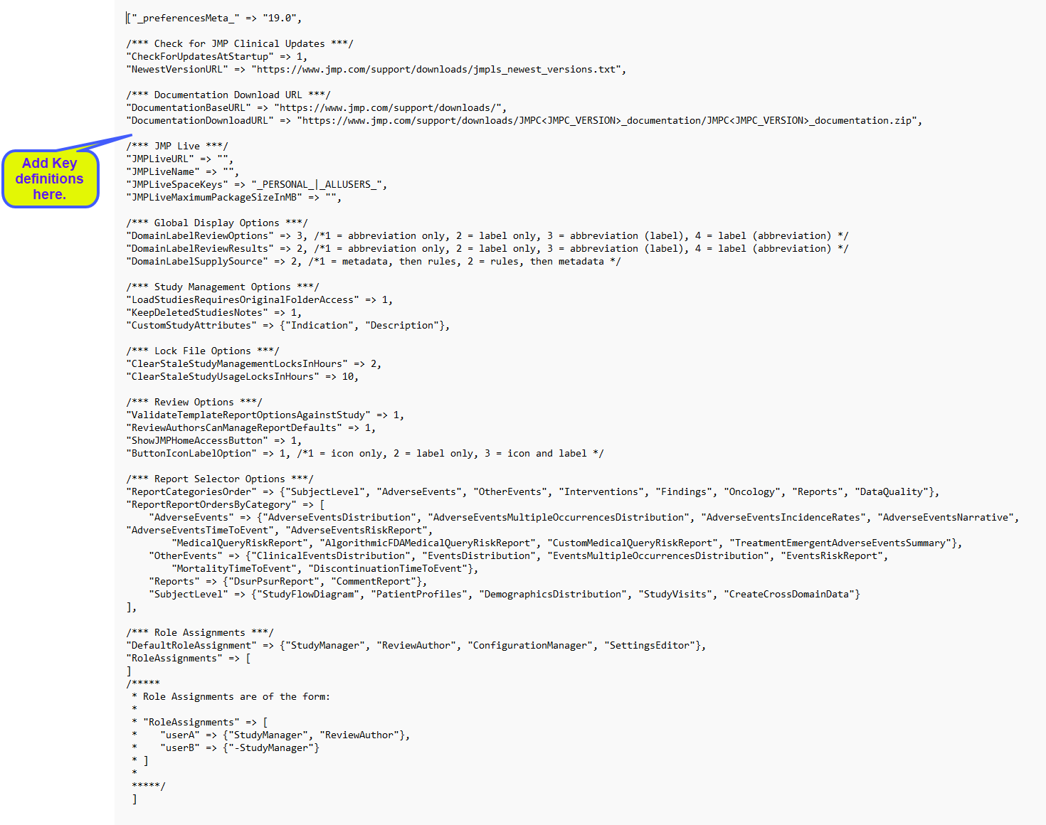

Use the following procedure for specifying alternative keys:
| 8 | Navigate to the location of the system.clinical.preferences file. Typically, this file is located in the ‘C:\Users\<username>\Documents\JMPClinical19\Configurations\Default’ directory. |
| 8 | Make a copy of the system.clinical.preferences file and save it under a different name to ensure that you retain a copy of the default file. |
| 8 | Open the system.clinical.preferences file. |
| 8 | Insert the nested associative array that specifies the keys to be used with your study. The array code should be inserted into the system.clinical.preferences file at the location shown above. |

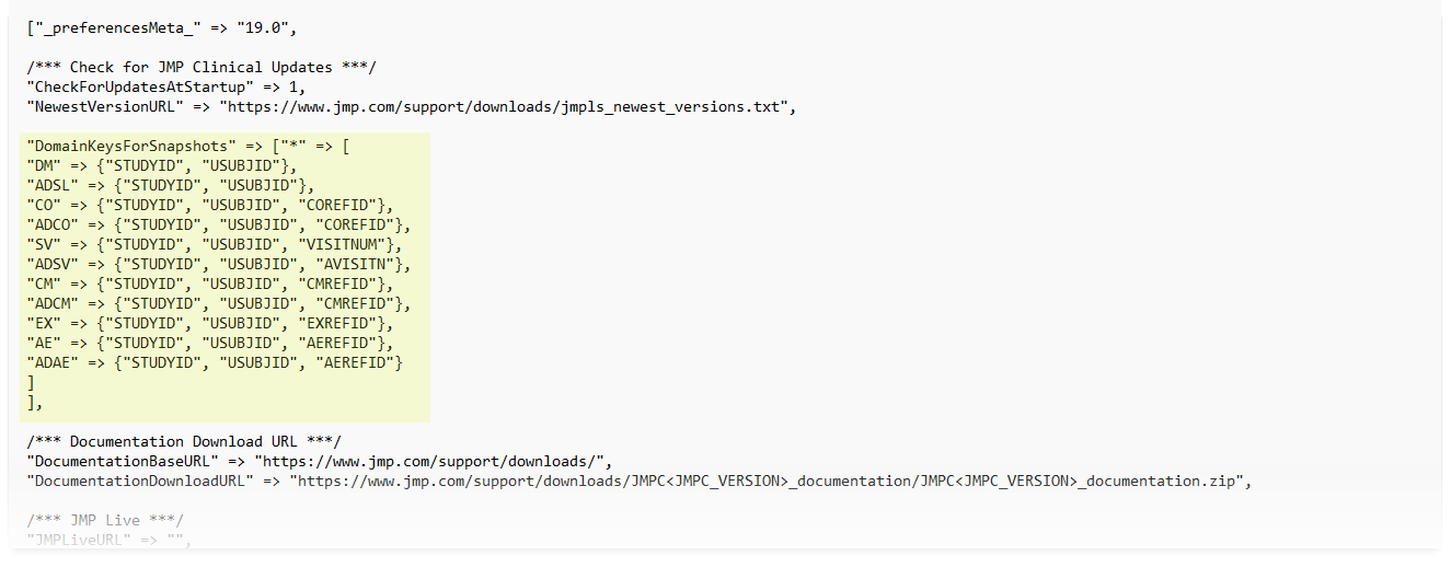

In this example, we insert the following array:
"DomainKeysForSnapshots" => ["*" => [
"DM" => {"STUDYID", "USUBJID"},
"ADSL" => {"STUDYID", "USUBJID"},
"CO" => {"STUDYID", "USUBJID", "COREFID"},
"ADCO" => {"STUDYID", "USUBJID", "COREFID"},
"SV" => {"STUDYID", "USUBJID", "VISITNUM"},
"ADSV" => {"STUDYID", "USUBJID", "AVISITN"},
"CM" => {"STUDYID", "USUBJID", "CMREFID"},
"ADCM" => {"STUDYID", "USUBJID", "CMREFID"},
"EX" => {"STUDYID", "USUBJID", "EXREFID"},
"AE" => {"STUDYID", "USUBJID", "AEREFID"},
"ADAE" => {"STUDYID", "USUBJID", "AEREFID"}
The modified system.clinical.preferences file is shown below. The array is shaded in yellow.
| 8 | Save the system.clinical.preferences file and close JMP Clinical. |
You must close and restart JMP Clinical for the changes to the system.clinical.preferences file to take effect.
