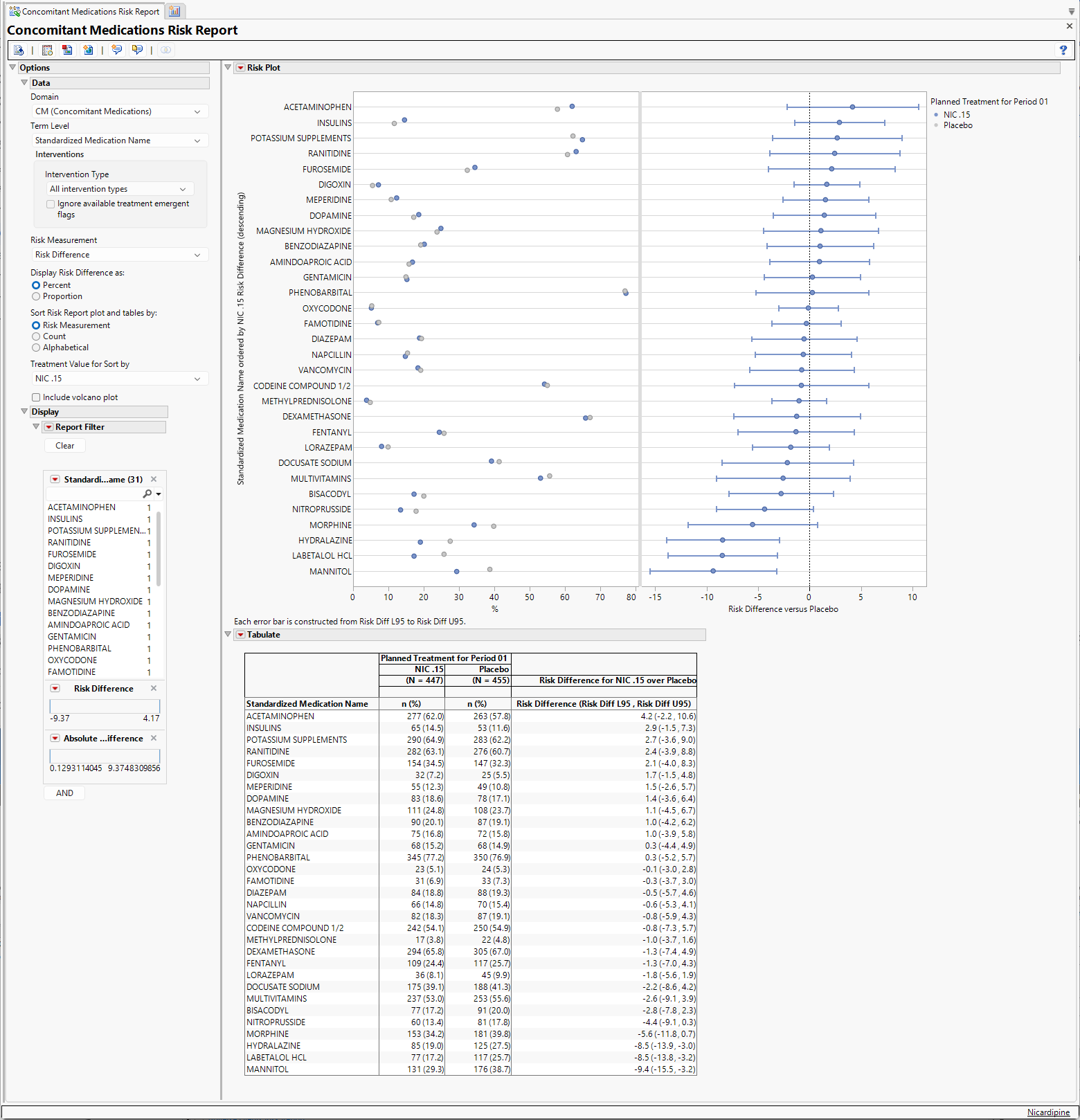

Interventions Risk Report
This report screens all interventions and calculates and generates forest plots of risk differences, relative risks or odds ratios. It reports each subject only once per intervention regardless of how many incidents of the intervention occur.
Report Results Description
Running this report for Nicardipine using default settings generates the report shown below.
Refer to the Adverse Events Risk Report , keeping in mind the following important differences in contrast with the example:
| • | Output (including section names) reflects intervention incidence corresponding to selected domain (e.g. Concomitant Medication, Substance Use), rather than adverse events, incidence |
| • | Term Level is allowed to equal Category (such as CMCAT or SUCAT, depending on the domain) |
