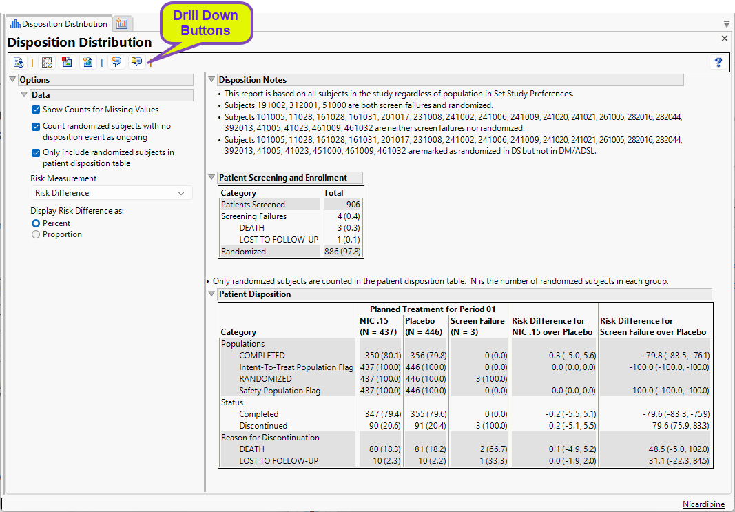

Disposition Distribution
This report generates tables showing the distribution of dispositions and associated risk differences of study patients across treatment arms.
Report Results Description
Running this report for Nicardipine using default settings generates the Report shown below.
The report contains notes and two tables:
Disposition Notes
The following notes describing disposition details may be included in this section.
| • | Subjects that are both screen failures and randomized are listed in the first note. |
| • | Subjects that are neither screen failures nor randomized are listed in the second note. However, if there is no randomization information in the data, this note states there is no randomization information. |
| • | Subjects that are marked as randomized in DM/ADSL but not in DS are listed in a third note. If randomization information only exists in DM/ADSL and not DS, then this note will state that randomization information is only in DM/ADSL. |
| • | Subjects that are marked as randomized in DS but not in DM/ADSL are listed in a fourth note. If randomization information only exists in DS and not in DM/ADSL, then this note will state that randomization information is only in DS. |
Patient Screening and Enrollment
This table lists the number of subjects screened, enrolled, and randomized in the study as applicable, as well as the number of screen failures with the reason for failure..

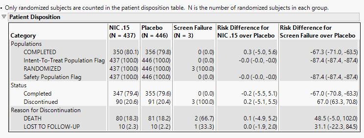

Patient Disposition
This table lists counts and percentages, along with risk difference measurements, of subjects dispositions by treatment arm. Categories include the study populations, completion status, and reason for discontinuation.
Options
Data
Show counts for missing values
Check this option to show counts of subjects who are missing disposition information. For example, subjects who left the study but the reasonfor their discontinuation is missing or subjects whose completion/discontinuation status is missing all together.
Count randomized subjects with no disposition event as ongoing
Check this box to count subjects as Ongoing who do not have either a Completed or Discontinued record in DS. Only subjects who have been randomized will be counted as Ongoing.
Only include randomized subjects in patient disposition table
Check this option to include only randomized subjects in the disposition table.
Risk Measurement
You have the option of calculating either the Risk Difference, the Relative Risk, or the Odds Ratio as the Risk Measurement.
Display Risk Difference as:
Use this widget to specify the difference between the risk of an event in the treatment arm and the control arm as either a percentage or a proportion of the total subject population. This widget appears only when you select Risk Difference as the Risk Measurement.
| • | Click to reset all report options to default settings. |
| • | Click to view the associated data tables. Refer to Show Tables for more information. |

In the second table, the populations section summarizes all of the population flags in the study. The status section is determined by the values of DSDECOD in the DS domain where DSCAT = “Disposition Event”. If the value is either “Completed” or “Complete”, then the patient is counted as completed. Otherwise patients with a non-missing value for Disposition Event are counted as Discontinued. Patients missing a response for Disposition Event are either counted as Ongoing, Missing, or excluded depending on the option selections. The reason for discontinuation is included for subjects who were counted as discontinued by summarizing the values of DSDECOD where DSCAT = “Disposition Event”. If the reason is missing for any subject, a category of Missing will be added to the summary depending on the option selections. If EPOCH or DSSCAT exist in the DS domain, the status and reason for discontinuation sections of the table will be split by the values in these two variables.
No testing is performed. Analysis is restricted to tabulating counts/percentages of subjects based on their disposition.
