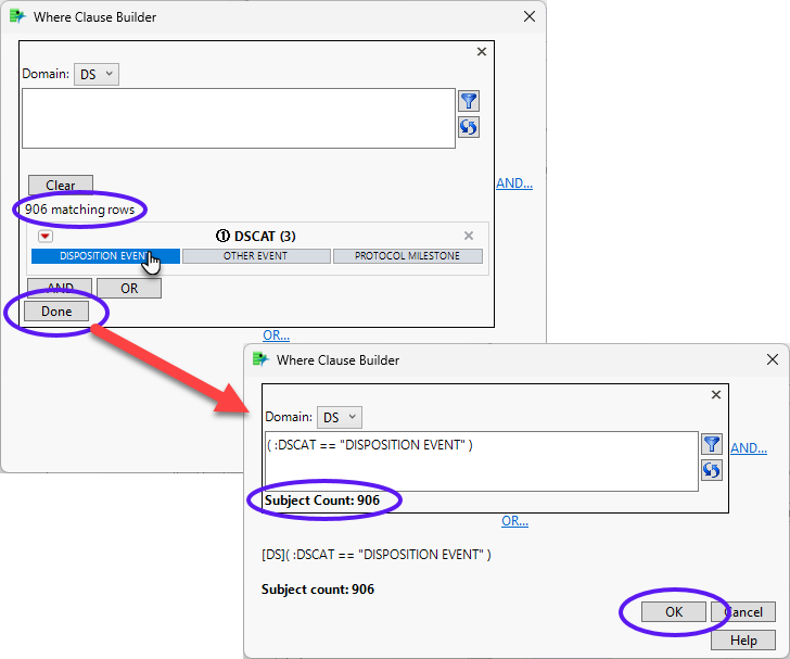

The example below uses the Disposition filter in Risk Based Monitoring. Here, the Disposition WHERE statement is used to select the records (one per subject) that indicate the subjects' completion or discontinuation status.

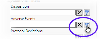

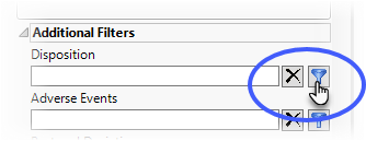

8 Click from the Disposition filter.
The Where Clause Builder opens.

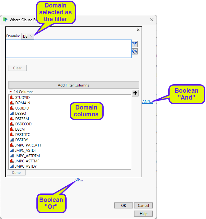

The DS domain is automatically selected as the domain. All of the columns in the domain are listed and are available for selecting.

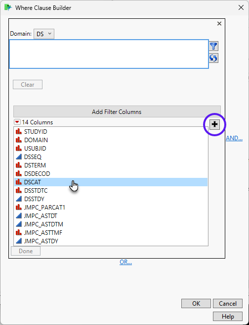

8 Double-click on a column to select that column. In this example, we select DSCAT and click .
The column list changes to a list of the different term categories contained in the selected column.

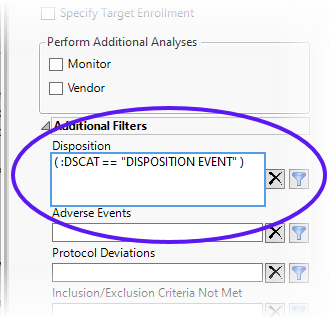

8 Select DISPOSITION EVENT and click . You can see that we have selected 906 observations which account for the 906 subjects in the Nicardipine study.
8 Click to add the filter to the report.

You might find it useful to combine multiple simple WHERE expressions into a single, compound WHERE expression. Expressions can be joined by using Boolean terms, such as AND and OR. Using AND will filter to and include those entities meeting the requirements of all of the specified filters. Using OR will filter to and include those entities meeting any of the specified filters.
Click either or once you have specified your first filter.

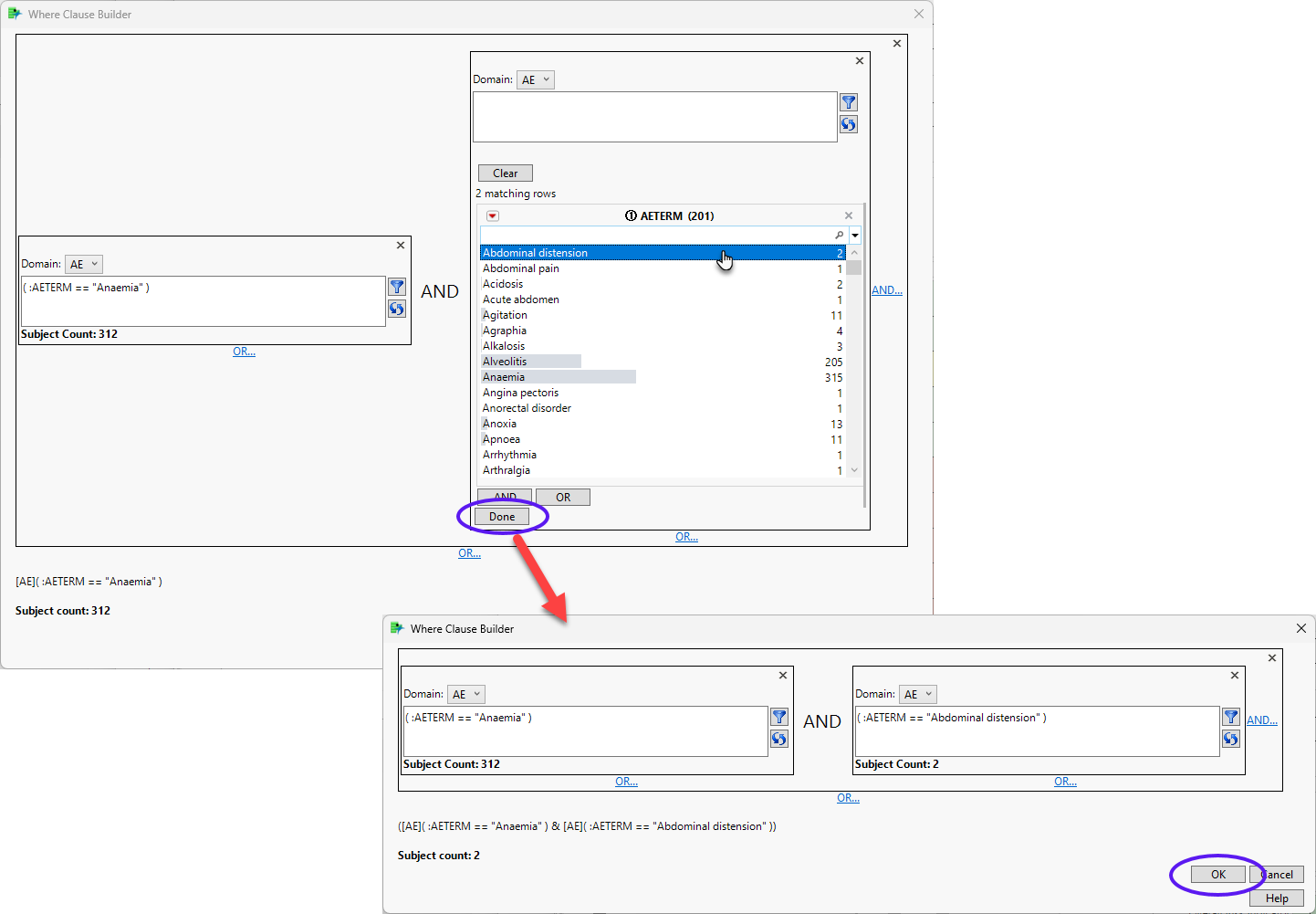

In the following example, we restrict the analysis to subjects who experience severe abdominal distension and anaemia.

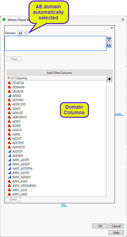

8 Click from the Adverse Events filter.
The AE domain is automatically selected as the domain. All of the columns in the domain are listed and are available for selecting.

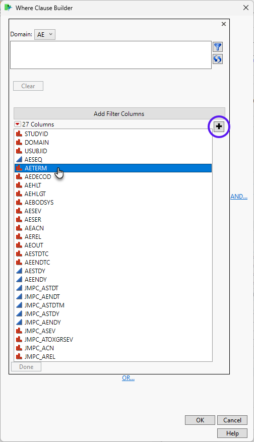

8 Click on a column to select that column. In this example, we select AETERM and click .

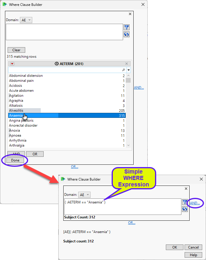

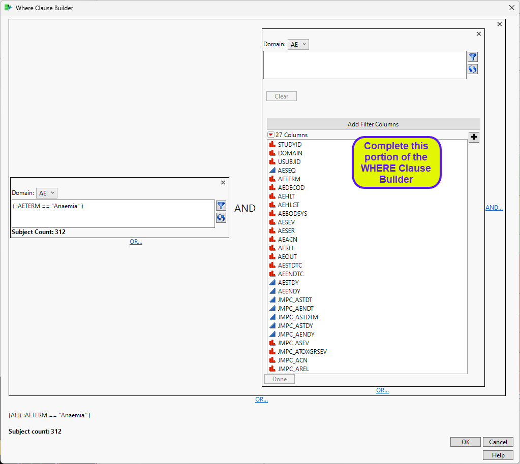

8 Select Anaemia and click to generate the simple WHERE expression.
8 Click (circled above) to generate a complex WHERE expression.
To complete the second portion of the expression, where AETERM is Abdominal Distension:
8 Select AETERM and click .

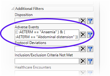

8 Click to add the WHERE expression to the filter in the report.
Note: You can add additional complexity to the filter anytime during this process by clicking on additional and/or buttons.
